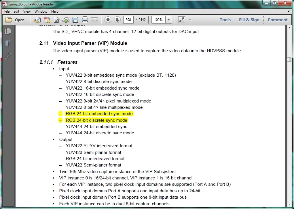

I am using DM8168 processor. I am trying to bring up Sony Camera (IMX136LQJ) in my customized platform.
I am using LVDS chip (SN65LVDS324) to send the data (parallel) from sensor to processor.
The LVDS chip is giving 16-bit RGB parallel data to the processor. The LVDS chip output is routed to VIP-0 (port A).
As per the data sheet, in the section 2.11.1 port A supports only 24-bit RGB data attached below:
Here, the processor supports only 24-bit RGB data, but our LVDS chip data output is 16-bit RGB format.
Please let us know, is it possible to send 16-bit RGB data to processor from VIP0(port A).
