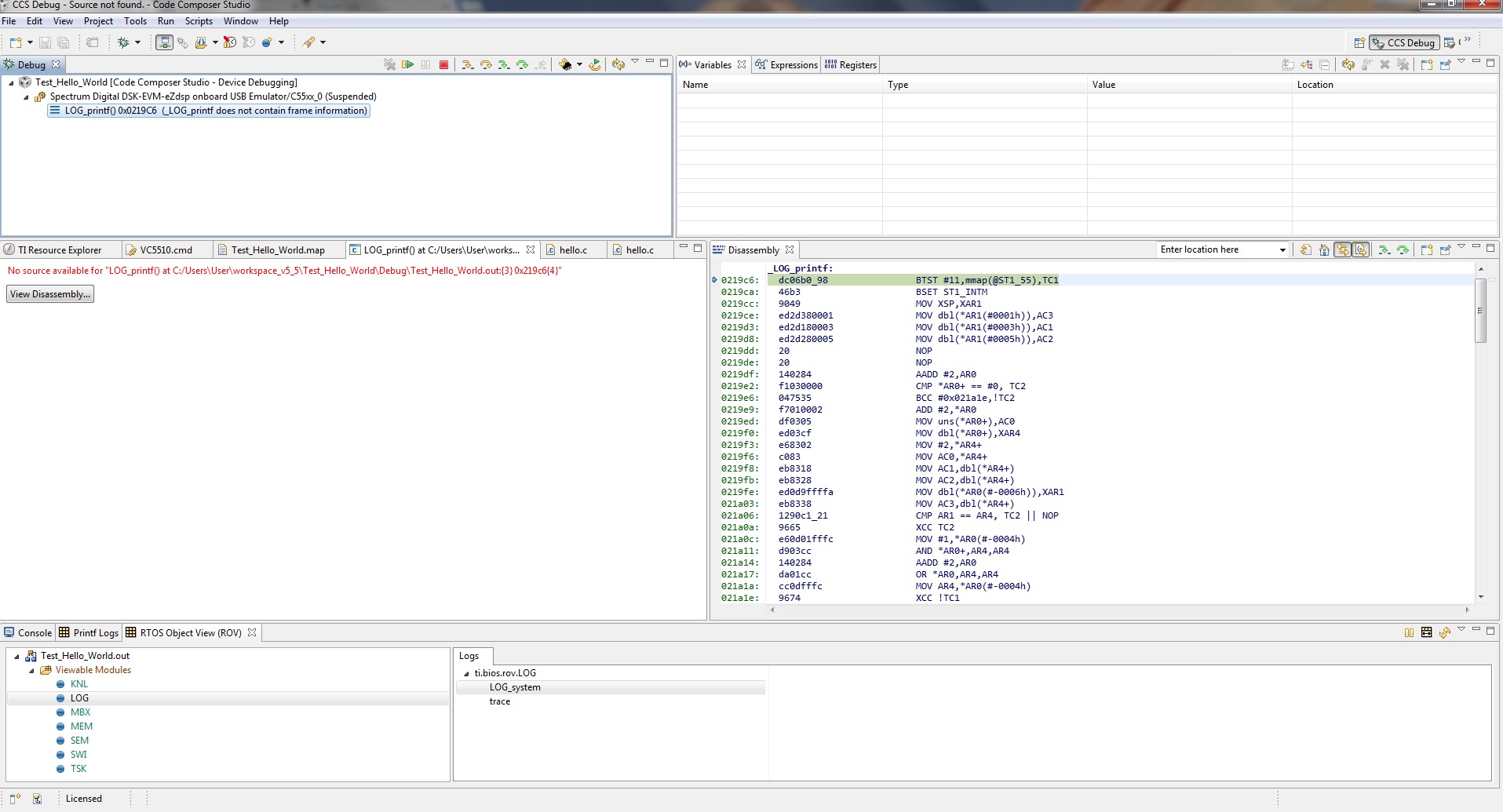

I have got a Spectrum Digital TMS320VC5510 DSK which I am trying to use with Code Composer Studio 5.5 or 6.1.
Using Spectrum Digital DSK-EVM-eZdsp onboard USB Emulator, I want to test the DSP/BIOS Hello example (the regular hello example works fine).
However when I start the program which is loaded in the platform and step into the function LOG_printf, I get the "No source available for LOG_printf" error even though the disassembly window shows that the program pointer points to a correct location. See the following picture.
The picture shows the error for CCS v5.5 but I get the same error with CCS 6.1.
Thereafter it looks like the communication with the board is lost and I have to restart the debug session.
Can you help me on this?
