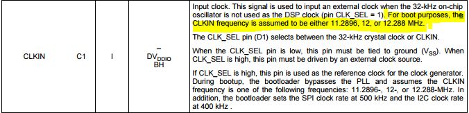

I want to supply the TMS320C5535 CLKIN with an external 5.000MHz (or 10.000MHz) and have it operate at exactly 50.000MHz.  Would there be a problem with this?  Wouldn't the I2C boot-loading routine still function (but just operate at slower speed)?
