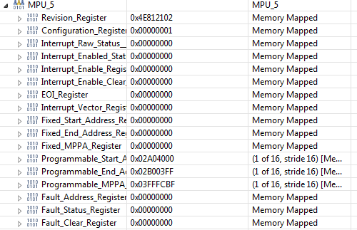

 After studying the MPU2(SPRUGW5A) user guide I programmed the instances of MPU2 & MPU5 in Core 0 main file in the following manner
    CSL_MpuHandle           hMpu5,hMpu2;
    hMpu5    = (CSL_MpuHandle)CSL_MPU_5_REGS;
    hMpu5->PROG_REGION[0].PROG_START_ADDRESS    = 0x02A04000;
    hMpu5->PROG_REGION[0].PROG_END_ADDRESS      = 0x02B00000;

    hMpu5->PROG_REGION[0].PROG_MPPA = 0x03FFFCBF;

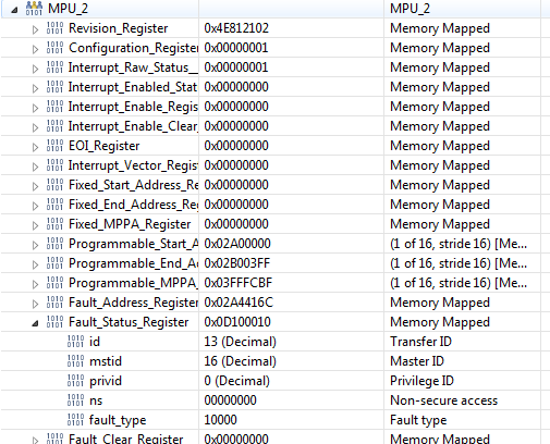

    hMpu2    = (CSL_MpuHandle)CSL_MPU_2_REGS;
    hMpu2->PROG_REGION[0].PROG_START_ADDRESS    = 0x02A00000;
    hMpu2->PROG_REGION[0].PROG_END_ADDRESS      = 0x02B00000;

    hMpu2->PROG_REGION[0].PROG_MPPA = 0x03FFFCBF;
I program the 2 instances because their address overlaps which each other according to K2L user guide.
But executing the code again give the same error again
[C66xx_0] Pktlib_createHeap(): [Error=-4] - Unable to create netfpDataRxHeap private heap
Here is the screenshot of Registers of MPU's
As can be seen from user guide of K2L the Master id is of CorePAC 0 CFG & having a supervisor write fault even though I have enable it in the MPU2 instance.
And I want to Know what is Transfer ID ??

  • There is supervisor write fault by master id 16(as indicated by the screenshot in my post ) which belong to corepac 0 CFG according K2L6630 user guide. The Fault address,which is same every time, lies in QMSS PEEK REGION because we try to set threshold value in D register (according to Multi core Navigator User guide). I tried changing the privilege level as shown in my post but the error remains same.
    Please tell How this memory access error can be resolved ??

  • Hi Ravi Raj Saxena,
    As per factory team the MPAX registers should be configured by the Linux kernel before running "Thershold" test case which is not supported on "DSP No boot" mode.
    Try below sequence,
    1. Boot the Linux on ARM cores and wait for root prompt.
    2. Connect to the DSP core0 using emulator on CCS without gel file.
    3. Load and run the application pktlib_DspOnlyk2hTestProject (.out) file.
    Thank you.

    Can it be programmed in the following manner ?
        /* Programmable Range n Memory Protection Page Attribute Register (PROGn_MPPA)
        *   31-26   25    24    23    22    21    20    19   18   17   16   15   14   13   12   11   10   9      8     7  6   5  4  3  2  1  0
        * Reserved AID15 AID14 AID13 AID12 AID11 AID10 AID9 AID8 AID7 AID6 AID5 AID4 AID3 AID2 AID1 AID0 AIDX Reserved NS EMU SR SW SX UR UW UX
    If not then How ?
