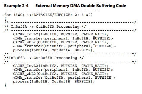

  • Last question.
    In the C66x Cache User Guide, the pseudo-code in the Example 2-4 shows below.
    It implement a Ping-pong Buffering on external memory similar as mine. The function "DMA_transfer" in our application is performed by EDMA. My question is: Does the CACHE_WAIT is necessary for invalidating InBuff? From my point of view, the function "process" will not use the invalidated Buffer until the next function "process" is called. So if the time consumption of invalidating InBuff is less than the time span between invalidating InBuff to calling the function "process", which uses the Invalidated InBuff,  I can use CACHE_NOWAIT. Is that correct?
    Thanks.
    Xining Yu
  • You are right, and should be careful as well.
    Without getting into the details of the example, if you use Buffer A that was previously moved, you do not need to wait until buffer B is completely moved. So in that sense, you are right, BUT
    You need to guarantee that moving buffer A is completely done before you start processing buffer A, and yes, it was moved during the previous processing, but you need to be sure. There are several ways to ensure that buffer A is completely in the memory, so pick one. (you can use EDMA event, or play other tricks)
    If you have any other question do not hesitate to submit it, but please submit it in a separate posting, so we can close this one
    Best regards
    Ran
