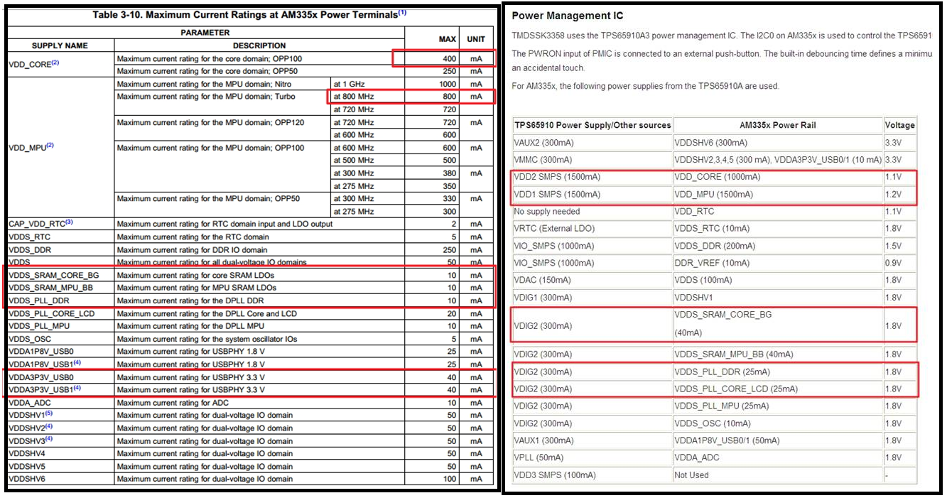

Hi Ti Team,
I am confused about the maximum current.
Which one is correct??
Datasheet or wiki ???
Thanks.
