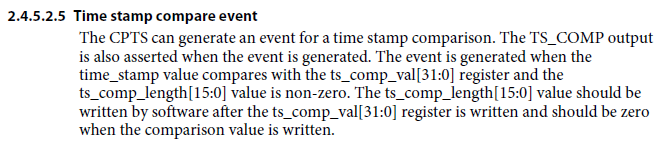

I want  to know whether CPTS of 1 gigabit ethernet is able to assert PPS?
Becasue according to SPRUHJ5 for 10 gigabit ethernet, it gives the following description:
whereas, in SPRUGV9D for 1 gigabit ethernet, I haven't found any similar description about TS_COMP output, ts_comp_val and ts_comp_length registers.
