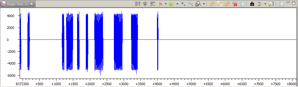

Hello forum,
i implemented the uPP-example given from this forum.
Now i want to monitor results via Tools-> Graph.
Converted is a sine wave with ~200kHz, clock is 2.5 MHz. (parameters will be adjusted later)
in the .cfg-File i added a line "Program.sectMap["uPPrcv_1"]                 = "L2SRAM" ", i also can link this section to "DDR3", results are the same.
Parameters are:
#define xferSize    (8192)    // max: 8192

Normally i would expect a continous blue pattern in the figure below, but i only see this :
When i change the amplitude of the input signal, i also can see these changes in the above y-axis.
My question is:
Why do i have intermissionsin between the sinus-signal?
Thanks in advance for any answer.
