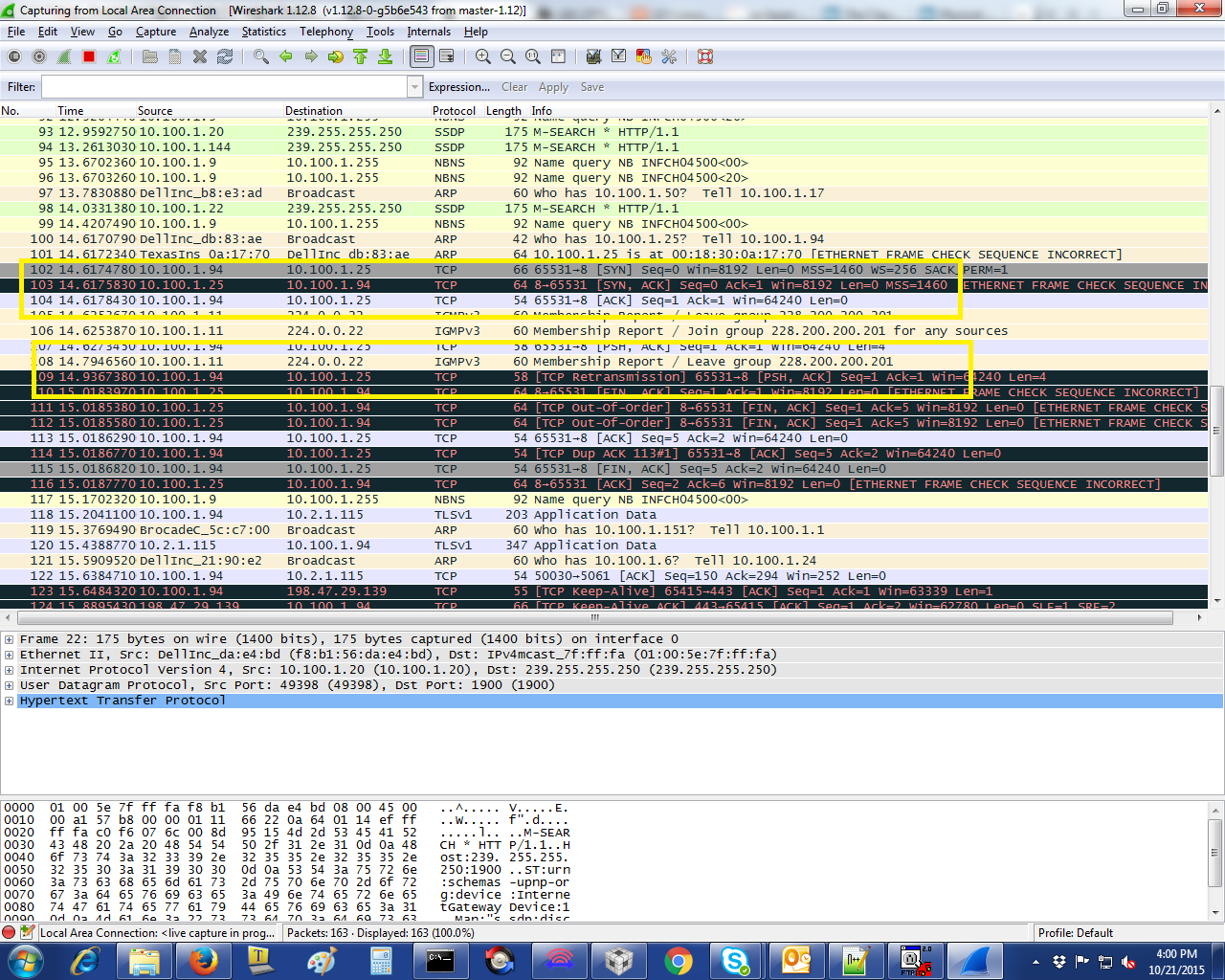

When the system first starts up, UDP packets on the C66 device are received correctly.  However, when I try to establish the TCP connection, I am seeing a delay of up to 40 seconds before the TI stack acknowledges the SYN request.
After this initial delay, the stack appears to be working correctly.
The attached snapshot of the wireshark window demonstrates the problem.

    This is what I got from wireshark.

    In short, I believe that I have found a workaround for the problem that I was seeing.
    Our system uses a full range of 32 priorities, and the default NDK task, NDK Stack Thread, was started at priority 5. Such a low priority meant that this thread was running very late during the initialization, way after the NDK was initialized. Since this task creates the NDK timer that strokes it every 100ms, my assumption is that such a late execution caused initialization hick-ups in the stack that self-cured over time.
    I found that there are two ways to resolve this issue:
    1. Up the priority of the NDK Stack Thread such that it is one of the first threads that get executed when the BIOS is started.
    2. Delay the IP address assignment until after the stack is up and running, and the system is in a stable state. In my case, I perform this address assignment from the NetworkOpen() function, which also works well for my application.
    Now, my diagnosis of the problem is just an assumption, and I would be very interested to get a more definitive explanation as to whether this assumption correct.
