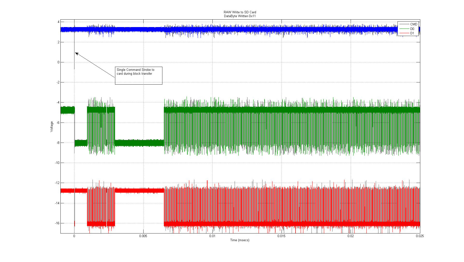

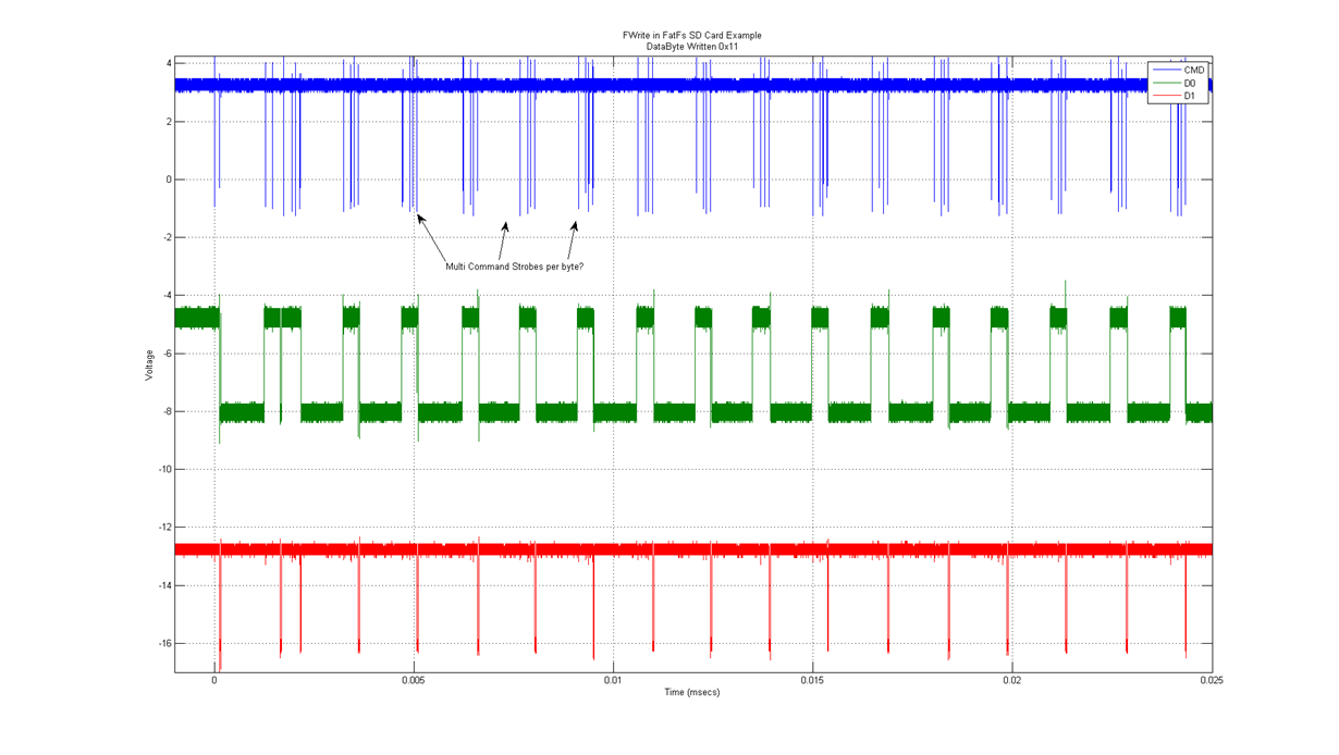

I am currently experimenting with the mmcsd_fatfs example in the biospsp_03_00_01_00 release.  I've gotten the project to run correctly and I can see files show up on my SD Card, however the time to write files seems extraordinarily long.  I am using a SanDisk Ultra 64GB microSDXC Class 10 UHS-1 which the vendor claims should be capable of 40MB/s (I know it's hard to achieve this) but using the project in the psp folder I'm seeing more like 300KB/s.
I've increased the write sectors to 500 which in the example program increases the buffer size to 256000 bytes.  This buffer is then directly passed to the fwrite call.
What am I missing?  I'm assuming that the psp driver using the FatFs can go faster and hopefully it's just a configuration setting that I'm missing.
Any help would be appreciated.
David

  • David,
    I found this Wiki page that talks about performance of the Linux drivers on the OMAP-L138, which is a superset of your C6748 and has the same peripheral features. It will at least let you know that you should be able to get better performance than you are seeing now.

    I've also taken some scope traces from the FatFs example and the raw file example.  I’ve attached to images of scope traces captured using the same time base.  You can see that when writing in the FatFs example the command line is very chatty, like the C6748 and the SD Card communicate on each byte to write.  In the raw example the C6748 and the SD Card talk once at the start of a transfer block and then data is transferred in large sections.
    Thank you for looking into this,
    David

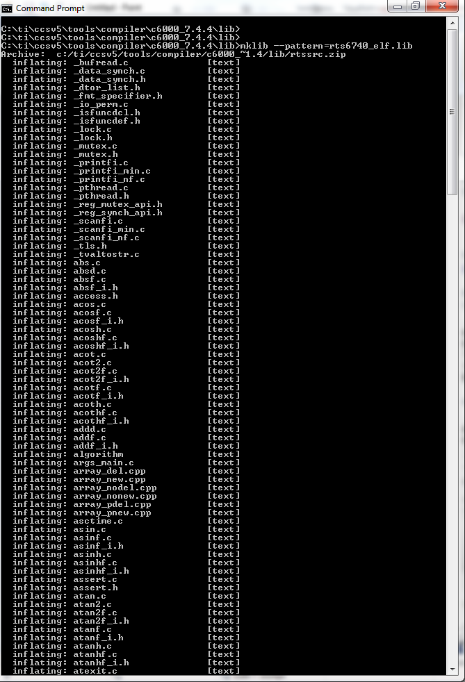

  • Dear Brian,
    Have you tried to build the library without any change as it is "rtssrc.zip" ?
    gmake.exe: *** No rule to make target `library'. Stop.
    >> ERROR: mklib: gmake error during rts67plus.lib build
    Where you are using this step ?
    You can't build into that library source directory, you can build only with zip based library source file "rtssrc.zip".
    Can you please do the following steps.
    1) Go to this directory "C:\ti\ccsv5\tools\compiler\c6000_7.4.4\lib" in command terminal.
    2) Rename the library "rts6740_elf.lib" to "rts6740_elf_bkp.lib" else you may get the following error.
    C:\ti\ccsv5\tools\compiler\c6000_7.4.4\lib>mklib --pattern=rts6740_elf.lib
    >> ERROR: mklib: destination library c:/ti/ccsv5/tools/compiler/c6000_~1.4/lib/\
    rts6740_elf.lib already exists
    3) Build the library without changing the source.
    4) Create one directory and copy the "rtssrc.zip" file into it then unzip there and modify the files then re-zip it again in same name "rtssrc.zip" and replace it "C:\ti\ccsv5\tools\compiler\c6000_7.4.4\lib\rtssrc.zip" (please take a backup of this src file)
    5) Build the modified library again.

    cl6x decode.c -o -oe -k -pdsw225 -q  -mo --mem_model:data=far --no_visible_enums -c --ti_lib --building_runtime -D_BOOL --abi=eabi -mv6740 -fg --rtti -Ic:/users/briand~1/appdata/local/temp/ti2bc9~1/src -fr c:/users/briand~1/appdata/local/temp/ti2bc9~1/obj -fs c:/users/briand~1/appdata/local/temp/ti2bc9~1/obj -ft c:/users/briand~1/appdata/local/temp/ti2bc9~1/obj
    process_begin: CreateProcess(NULL, cl6x decode.c -o -oe -k -pdsw225 -q -mo --mem_model:data=far --no_visible_enums -c --ti_lib --building_runtime -D_BOOL --abi=eabi -mv6740 -fg --rtti -Ic:/users/briand~1/appdata/local/temp/ti2bc9~1/src -fr c:/users/briand~1/appdata/local/temp/ti2bc9~1/obj -fs c:/users/briand~1/appdata/local/temp/ti2bc9~1/obj -ft c:/users/briand~1/appdata/local/temp/ti2bc9~1/obj, ...) failed.
    cl6x negll.sa -o -oe -k -pdsw225 -q  -mo --mem_model:data=far --no_visible_enums -c --ti_lib --building_runtime -D_BOOL --abi=eabi -mv6740 --gcc -Ic:/users/briand~1/appdata/local/temp/ti2bc9~1/src -fr c:/users/briand~1/appdata/local/temp/ti2bc9~1/obj -fs c:/users/briand~1/appdata/local/temp/ti2bc9~1/obj -ft c:/users/briand~1/appdata/local/temp/ti2bc9~1/obj
    process_begin: CreateProcess(NULL, cl6x negll.sa -o -oe -k -pdsw225 -q -mo --mem_model:data=far --no_visible_enums -c --ti_lib --building_runtime -D_BOOL --abi=eabi -mv6740 --gcc -Ic:/users/briand~1/appdata/local/temp/ti2bc9~1/src -fr c:/users/briand~1/appdata/local/temp/ti2bc9~1/obj -fs c:/users/briand~1/appdata/local/temp/ti2bc9~1/obj -ft c:/users/briand~1/appdata/local/temp/ti2bc9~1/obj, ...) failed.
    cl6x wchar.cx -o -oe -k -pdsw225 -q  -mo --mem_model:data=far --no_visible_enums -c --ti_lib --building_runtime -D_BOOL --abi=eabi -mv6740 --gcc -Ic:/users/briand~1/appdata/local/temp/ti2bc9~1/src -fr c:/users/briand~1/appdata/local/temp/ti2bc9~1/obj -fs c:/users/briand~1/appdata/local/temp/ti2bc9~1/obj -ft c:/users/briand~1/appdata/local/temp/ti2bc9~1/obj
    process_begin: CreateProcess(NULL, cl6x wchar.cx -o -oe -k -pdsw225 -q -mo --mem_model:data=far --no_visible_enums -c --ti_lib --building_runtime -D_BOOL --abi=eabi -mv6740 --gcc -Ic:/users/briand~1/appdata/local/temp/ti2bc9~1/src -fr c:/users/briand~1/appdata/local/temp/ti2bc9~1/obj -fs c:/users/briand~1/appdata/local/temp/ti2bc9~1/obj -ft c:/users/briand~1/appdata/local/temp/ti2bc9~1/obj, ...) failed.
    cl6x tanh.c -o -oe -k -pdsw225 -q  -mo --mem_model:data=far --no_visible_enums -c --ti_lib --building_runtime -D_BOOL --abi=eabi -mv6740 --gcc  -Ic:/users/briand~1/appdata/local/temp/ti2bc9~1/src -fr c:/users/briand~1/appdata/local/temp/ti2bc9~1/obj -fs c:/users/briand~1/appdata/local/temp/ti2bc9~1/obj -ft c:/users/briand~1/appdata/local/temp/ti2bc9~1/obj
    process_begin: CreateProcess(NULL, cl6x tanh.c -o -oe -k -pdsw225 -q -mo --mem_model:data=far --no_visible_enums -c --ti_lib --building_runtime -D_BOOL --abi=eabi -mv6740 --gcc -Ic:/users/briand~1/appdata/local/temp/ti2bc9~1/src -fr c:/users/briand~1/appdata/local/temp/ti2bc9~1/obj -fs c:/users/briand~1/appdata/local/temp/ti2bc9~1/obj -ft c:/users/briand~1/appdata/local/temp/ti2bc9~1/obj, ...) failed.
    cl6x autoinit.c -o -oe -k -pdsw225 -q  -mo --mem_model:data=far --no_visible_enums -c --ti_lib --building_runtime -D_BOOL --abi=eabi -mv6740 --gcc -Ic:/users/briand~1/appdata/local/temp/ti2bc9~1/src -fr c:/users/briand~1/appdata/local/temp/ti2bc9~1/obj -fs c:/users/briand~1/appdata/local/temp/ti2bc9~1/obj -ft c:/users/briand~1/appdata/local/temp/ti2bc9~1/obj
    process_begin: CreateProcess(NULL, cl6x autoinit.c -o -oe -k -pdsw225 -q -mo --mem_model:data=far --no_visible_enums -c --ti_lib --building_runtime -D_BOOL --abi=eabi -mv6740 --gcc -Ic:/users/briand~1/appdata/local/temp/ti2bc9~1/src -fr c:/users/briand~1/appdata/local/temp/ti2bc9~1/obj -fs c:/users/briand~1/appdata/local/temp/ti2bc9~1/obj -ft c:/users/briand~1/appdata/local/temp/ti2bc9~1/obj, ...) failed.
    cl6x cpp_init.c -o -oe -k -pdsw225 -q  -mo --mem_model:data=far --no_visible_enums -c --ti_lib --building_runtime -D_BOOL --abi=eabi -mv6740 --gcc -Ic:/users/briand~1/appdata/local/temp/ti2bc9~1/src -fr c:/users/briand~1/appdata/local/temp/ti2bc9~1/obj -fs c:/users/briand~1/appdata/local/temp/ti2bc9~1/obj -ft c:/users/briand~1/appdata/local/temp/ti2bc9~1/obj
    process_begin: CreateProcess(NULL, cl6x cpp_init.c -o -oe -k -pdsw225 -q -mo --mem_model:data=far --no_visible_enums -c --ti_lib --building_runtime -D_BOOL --abi=eabi -mv6740 --gcc -Ic:/users/briand~1/appdata/local/temp/ti2bc9~1/src -fr c:/users/briand~1/appdata/local/temp/ti2bc9~1/obj -fs c:/users/briand~1/appdata/local/temp/ti2bc9~1/obj -ft c:/users/briand~1/appdata/local/temp/ti2bc9~1/obj, ...) failed.
    cl6x boot.c -o -oe -k -pdsw225 -q  -mo --mem_model:data=far --no_visible_enums -c --ti_lib --building_runtime -D_BOOL --abi=eabi -mv6740 --gcc -Ic:/users/briand~1/appdata/local/temp/ti2bc9~1/src -fr c:/users/briand~1/appdata/local/temp/ti2bc9~1/obj -fs c:/users/briand~1/appdata/local/temp/ti2bc9~1/obj -ft c:/users/briand~1/appdata/local/temp/ti2bc9~1/obj
    process_begin: CreateProcess(NULL, cl6x boot.c -o -oe -k -pdsw225 -q -mo --mem_model:data=far --no_visible_enums -c --ti_lib --building_runtime -D_BOOL --abi=eabi -mv6740 --gcc -Ic:/users/briand~1/appdata/local/temp/ti2bc9~1/src -fr c:/users/briand~1/appdata/local/temp/ti2bc9~1/obj -fs c:/users/briand~1/appdata/local/temp/ti2bc9~1/obj -ft c:/users/briand~1/appdata/local/temp/ti2bc9~1/obj, ...) failed.
    cl6x dtos.c -o -oe -k -pdsw225 -q  -mo --mem_model:data=far --no_visible_enums -c --ti_lib --building_runtime -D_BOOL --abi=eabi -mv6740 --gcc -Ic:/users/briand~1/appdata/local/temp/ti2bc9~1/src -fr c:/users/briand~1/appdata/local/temp/ti2bc9~1/obj -fs c:/users/briand~1/appdata/local/temp/ti2bc9~1/obj -ft c:/users/briand~1/appdata/local/temp/ti2bc9~1/obj
    process_begin: CreateProcess(NULL, cl6x dtos.c -o -oe -k -pdsw225 -q -mo --mem_model:data=far --no_visible_enums -c --ti_lib --building_runtime -D_BOOL --abi=eabi -mv6740 --gcc -Ic:/users/briand~1/appdata/local/temp/ti2bc9~1/src -fr c:/users/briand~1/appdata/local/temp/ti2bc9~1/obj -fs c:/users/briand~1/appdata/local/temp/ti2bc9~1/obj -ft c:/users/briand~1/appdata/local/temp/ti2bc9~1/obj, ...) failed.
    make (e=2): The system cannot find the file specified.
    gmake.exe: *** [c:/users/briand~1/appdata/local/temp/ti2bc9~1/obj/decode.obj] Error 2
    gmake.exe: *** Waiting for unfinished jobs....
    gmake.exe: *** [c:/users/briand~1/appdata/local/temp/ti2bc9~1/obj/negll.obj] Error 2
    gmake.exe: *** [c:/users/briand~1/appdata/local/temp/ti2bc9~1/obj/wchar.obj] Error 2
    gmake.exe: *** [c:/users/briand~1/appdata/local/temp/ti2bc9~1/obj/tanh.obj] Error 2
    gmake.exe: *** [c:/users/briand~1/appdata/local/temp/ti2bc9~1/obj/autoinit.obj] Error 2
    gmake.exe: *** [c:/users/briand~1/appdata/local/temp/ti2bc9~1/obj/cpp_init.obj] Error 2
    gmake.exe: *** [c:/users/briand~1/appdata/local/temp/ti2bc9~1/obj/boot.obj] Error 2
    gmake.exe: *** [c:/users/briand~1/appdata/local/temp/ti2bc9~1/obj/dtos.obj] Error 2
    >> ERROR: mklib: gmake error during rts6740_elf.lib build
    C:\ti\ccsv6\tools\compiler\c6000_7.4.15\lib>
