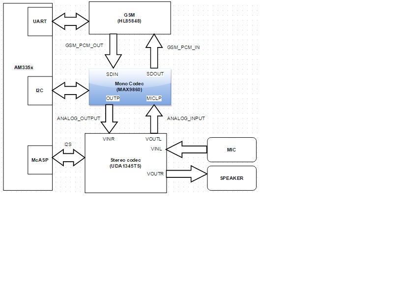

Dear TI E2E Community,
Am hearing the clicks sound as soon as my GSM call ALSA application is started, I tried turning off the ADC & DAC in my stereo codec(UDA1345TS interfaced to davinci mcasp0) during bootup using amixer & then ran my GSM app, but still am hearing this issue
For your reference, I have hereby attached the GSM application & the asound.conf(modified for routing)
Application design
GSM MIC [Analog Data]->GSM_PCM_OUT [Digital Data]->SDIN[Digital Data]->OUTP[Analog Data] ->VINR[Analog Data] ->I2S[Digital Data]-> VOUTR[Analog Data]-> Board Speaker[Analog Data]
GSM Speaker [Analog Data] <- GSM_PCM_IN[Digital Data] <- SDOUT[Digital Data] <- MICLP [Analog Data]<- VOUTL [Analog Data]<- I2S [Digital Data] <-VINL[Analog Data]<-Board MIC [Analog Data]

Could you please help me out or provide any valuable inputs or guidance w.r.t the issue
Other option am thinking is to turn off the ADC & DAC in stereo codec inside the GSM app
Kindly do the needful as early as possible,
Many thanks in advance
  • GSM clicks usually are inducted directly onto PCB traces during initial phase of call, when GSM power levels are established with the GSM network. Software will not help you here. You will need filtering on the audio lines and possibly on power supplies to suppress these noises.
