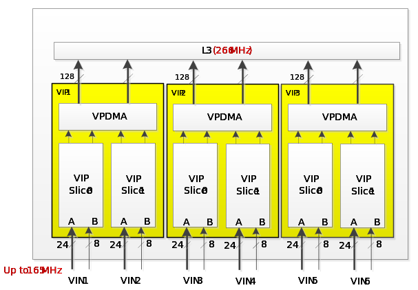

Would you please teach me the maximum video input interface number of AM572x family?
It seems that there are three video input module, but this module can input two video streem. So, that maximum values are 6. Is my understanding correct?

    - There are 3 three VIP (Video Input Ports) modules in AM572x family (AM5728 and AM5726)
    #Q: It seems that there are three video input module, but this module can input two video streem. So, that maximum values are 6. Is my understanding correct?
    • Each VIP supports 2-input stream parser slices
    • Each VIP slice can handle two streams: Port-A: 8/16/24-bit options Port-B: 8-bit only
    Each parser can handle two streams – (Port-A: 8/16/24-bit and Port-B: 8-bit configuration).

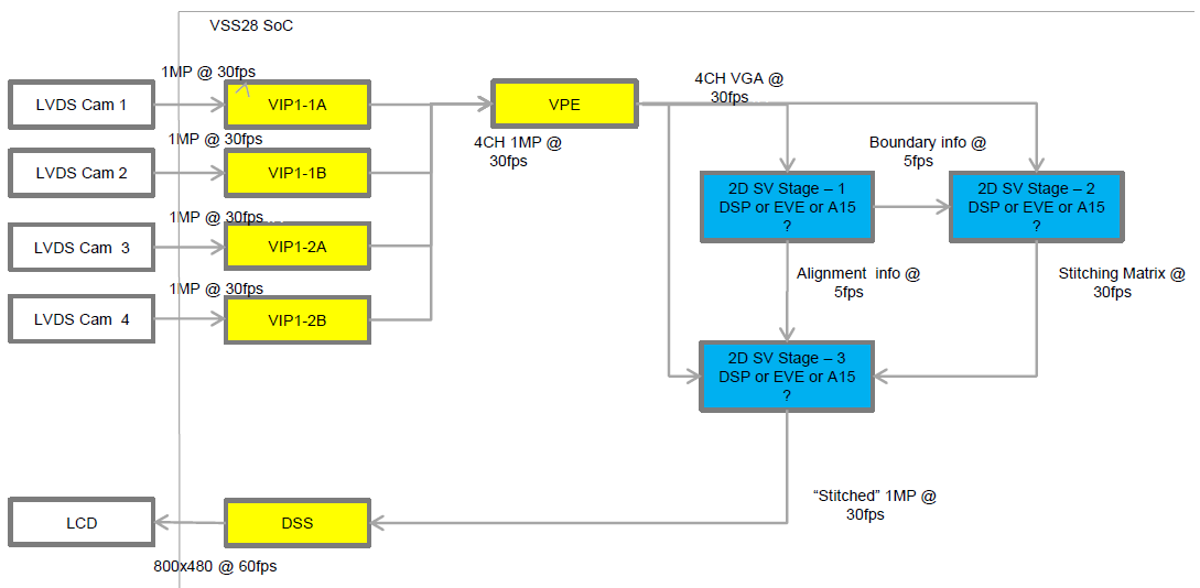

    Actually have you ever seen to use the six video input application by using this device?
    I would like to know whether this device can work correctly with maximum video inputs.

  • #Q: Actually have you ever seen to use the six video input application by using this device?
    The answer on your question depends on different factors. Yes, there are some customers, who have used all inputs of VIP modules.
    Please see the following example:
