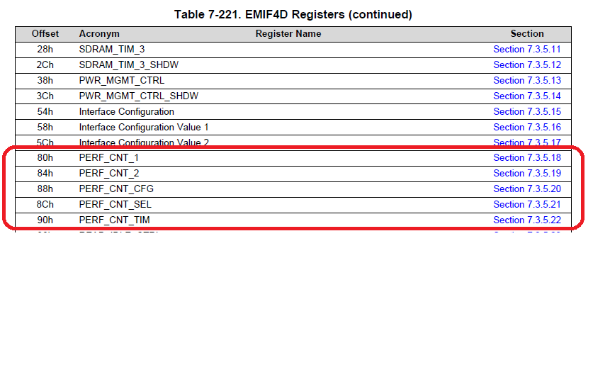

I have some questions for AM335x.
I'd like to use a Performance Counter of EMIF4D for DDR band-width check.
1) I think a user can select the transfer source(MConnID) in performance counter configuration.
    Where can I find the MConnID table?
  Of course, I'v seen the "Filter Configurations for Performance Counters" of TRM.  So I know there is a case that can not select it
2) Also, I think user can MAddrSpace in performance counter configuration.
   What is the MaddrSpace? How value is reg_region_selX set?
3) I'd like know the margin of ​DDR bandwidh ​on customer system.
  So I will try to check in this Performance Counter register​.
 Please let me know if you know of any better way/method than this Performance Counter register​.
    Table 10-1. L3 Master — Slave Connectivity.  See the "Master ID" column.
    It corresponds to the chip select space, but AM335x only has a single chip select (CS0) so you would just leave it as zero.
  • Hi
    Thank you very much for your kind support.
    I understood that MConnID is Master ID and MAddrSpace is not used for AM335x (CS0 only).
    I will try it!
