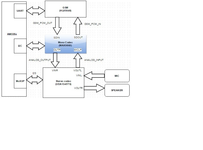

Dear Ti E2E Community,
I facing the below error, am using am335x & ti sdk 8
Something wrong when execute arecord & aplay :
arecord and aplay does not work for the first time & it works after throwing error after 5 times
Couple of times I get the below error:
root@lifeline:/# arecord -D VINL8 -f S16_LE | aplay -D VOUTR8

  • Hello Srini,
    How do you set-up and route the channels?
    Could you share the etc/asound.conf?
    Kemal

    Dear Kemal,
    Hope you are doing good, am very happy that you are addressing this thread
    For your reference, I have hereby attached the asound.conf(modified for routing)
    I the stereo codec (UDA1345TS) Sound card, I have created four devices ie., VINL8, VINR8, VOUTL8 & VOUTR8 using dsnoop & dshare in asound.conf
    And made use of these four devices for my application as described below
    Application design
    GSM MIC [Analog Data]->GSM_PCM_OUT [Digital Data]->SDIN[Digital Data]->OUTP[Analog Data] ->VINR[Analog Data] ->I2S[Digital Data]-> VOUTR[Analog Data]-> Board Speaker[Analog Data]
    GSM Speaker [Analog Data] <- GSM_PCM_IN[Digital Data] <- SDOUT[Digital Data] <- MICLP [Analog Data]<- VOUTL [Analog Data]<- I2S [Digital Data] <-VINL[Analog Data]<-Board MIC [Analog Data]
    Kindly do the needful as early as possible
    Many Thanks in advance

    And two more points, I would like to share with you is
    1. As per my application design, Am trying to do the loopback as per the below commands manually,  I face the error some times as per the logs shown below, but after the below errors as shown in the below logs, then again If I rerun manually it works fine
    arecord -D VINL8 -f S16_LE | aplay -D VOUTL8 &
    arecord -D VINR8 -f S16_LE | aplay -D VOUTR8 &
