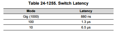

    If RT patch is applied in Linux Kernel, whether following performance can be achieved
    Ethernet packet arrival jitter within 50us in user space
    Ethernet latency within 100us in user space
    See the GMAC switch latency, there is no information about Ethernet latency in user space:
