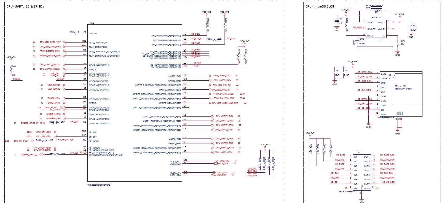

We are using TMS320DM8168CCYGA2 in our design. We have the micro SD interface to the processor for booting and file transfer functions.
Now we are finding inconsistency in the working of SD interface.
We are getting the IO error while booting the device, or while trying to access the file system.
We already proved the design in a prototype board with same design. Now we are in production stage and assembled one board initially. In this board we are observing this inconsistency.
We have measured all the resistor values on the board w.r.t. design
We have also checked with different SD cards with working code.
When we tried to probe the Clock and data lines at the connector with CRO,
we found that when the board boots properly, the Data and clock lines are alive
and when the IO error occurs, we see that clock and data lines go low.
We are unable to find out the cause for the issue, as we already have a board of same design with no issues.
Can anybody please help us with this.
How can we debug the issue and move forward.
Please find the attached schematics and error file for reference.

  • Hi I am Vijetha, Nanjunda's colleague.
    We had designed and Tested a board of same schematics and board design. We are checking the same microSD card in that board, did not observe any issue. Now we have one more board of same design, which shows IO error (inconsistently) when running same microSD card. So where can be the issue here?
    We are stuck in the beginning as we cant check any other Interfaces without solving this issue. Please help us in addressing this issue.
    Vijetha

    As a debug process, we reduced the clock frequency (SD_CLK) to 25MHz, the SD interface worked without any failure.
    Later we increased the clock frequency step by step to 48MHz and we did not see any failure or error in the working of micro SD interface.
    But for frequency above 48MHz, the same error was observed.
    (Note: The operating clock frequency initially was 50MHz)
    Can anyone please suggest us , how do we proceed further to solve the issue.
    We look forward for quick reply. We are lacking our schedule. Please help us ASAP.
    Thank you,
    Nanjunda M
  • Hi Nanjunda,
    SD/SDIO module can operate in two modes:
    1. Standard mode - SD_CLK operating frequency is max 24MHz
    2. High-Speed mode - SD_CLK operating frequency is max 48MHz
    See DM816x datasheet, section 9.16.2 SD and SDIO Electrical Data and Timing
    See also DM816x Silicon Errata, advisory 2.1.106 SDIO: SD_SDCD Pin Used as an GPIO Input Affects SDIO Operation
    BR
    Pavel
