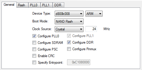

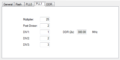

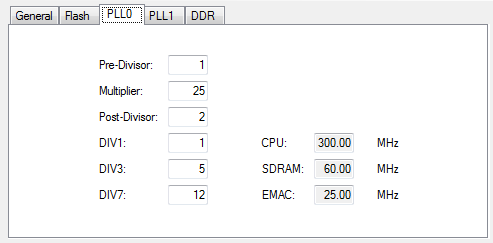

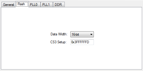

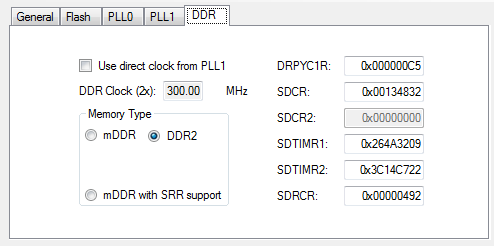

    For the settings in AISgen, I'm using the OMAPL138_LCDK_AISGen_Config file that came with it.  I'll paste the contents here in case you don't have it handy:
    Boot Mode=NAND Flash
    Boot Speed=115200
    Flash Width=1
    Flash Timing=3ffffffd
    Configure Peripheral=False
    Configure PLL0=True
    Configure SDRAM=False
    Configure PLL1=True
    Configure DDR2=True
    Configure LPSC=False
    Configure Pinmux=False
    Enable CRC=False
    Specify Entrypoint=False
    Enable Sequential Read=False
    Use 4.5 Clock Divider=False
    Use DDR2 Direct Clock=False
    Use mDDR=False
    ROM ID=3
    Device Type=0
    Input Clock Speed=24
    Clock Type=0
    PLL0 Pre Divider=1
    PLL0 Multiplier=25
    PLL0 Post Divider=2
    PLL0 Div1=1
    PLL0 Div3=5
    PLL0 Div7=12
    PLL1 Multiplier=25
    PLL1 Post Divider=2
    PLL1 Div1=1
    PLL1 Div2=2
    PLL1 Div3=3
    Entrypoint=c1080000
    SDRAM SDBCR=0
    SDRAM SDTMR=0
    SDRAM SDRSRPDEXIT=0
    SDRAM SDRCR=0
    DDR2 PHY=c5
    DDR2 SDCR=134832
    DDR2 SDCR2=0
    DDR2 SDTIMR=264a3209
    DDR2 SDTIMR2=3c14c722
    DDR2 SDRCR=492
    LPSC0 Enable=
    LPSC0 Disable=
    LPSC0 SyncRst=
    LPSC1 Enable=13+
    LPSC1 Disable=
    LPSC1 SyncRst=
    Pinmux=
    App File String=
    AIS File Name=
    And here are the resulting screenshots:

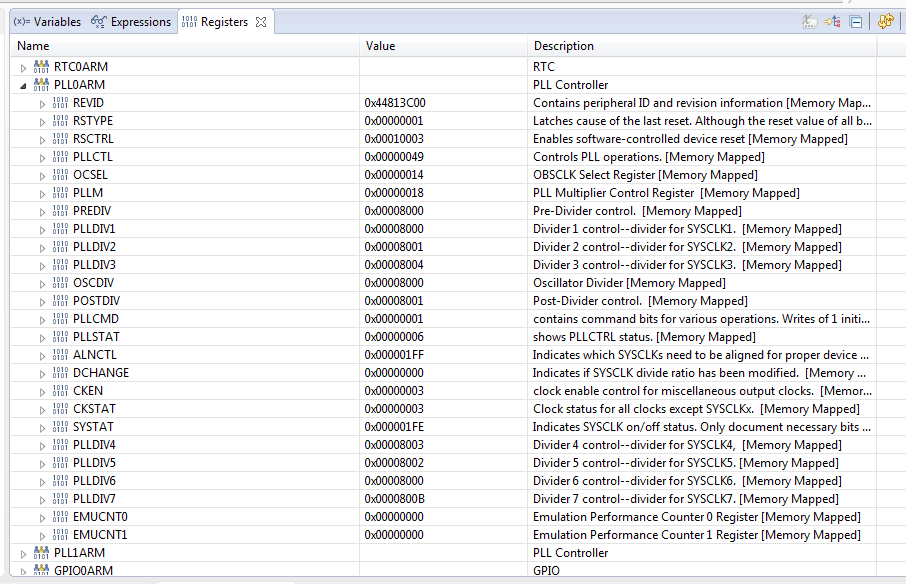

  • Do the PLL and PSC functions work? Those were the main ones I was interested in.
  • Yes, when I run those functions by themselves, they seem to work.  Output is attached. The output of these tests seems to be identical between the AISgen version and the hexAIS one.gel_output.zip
