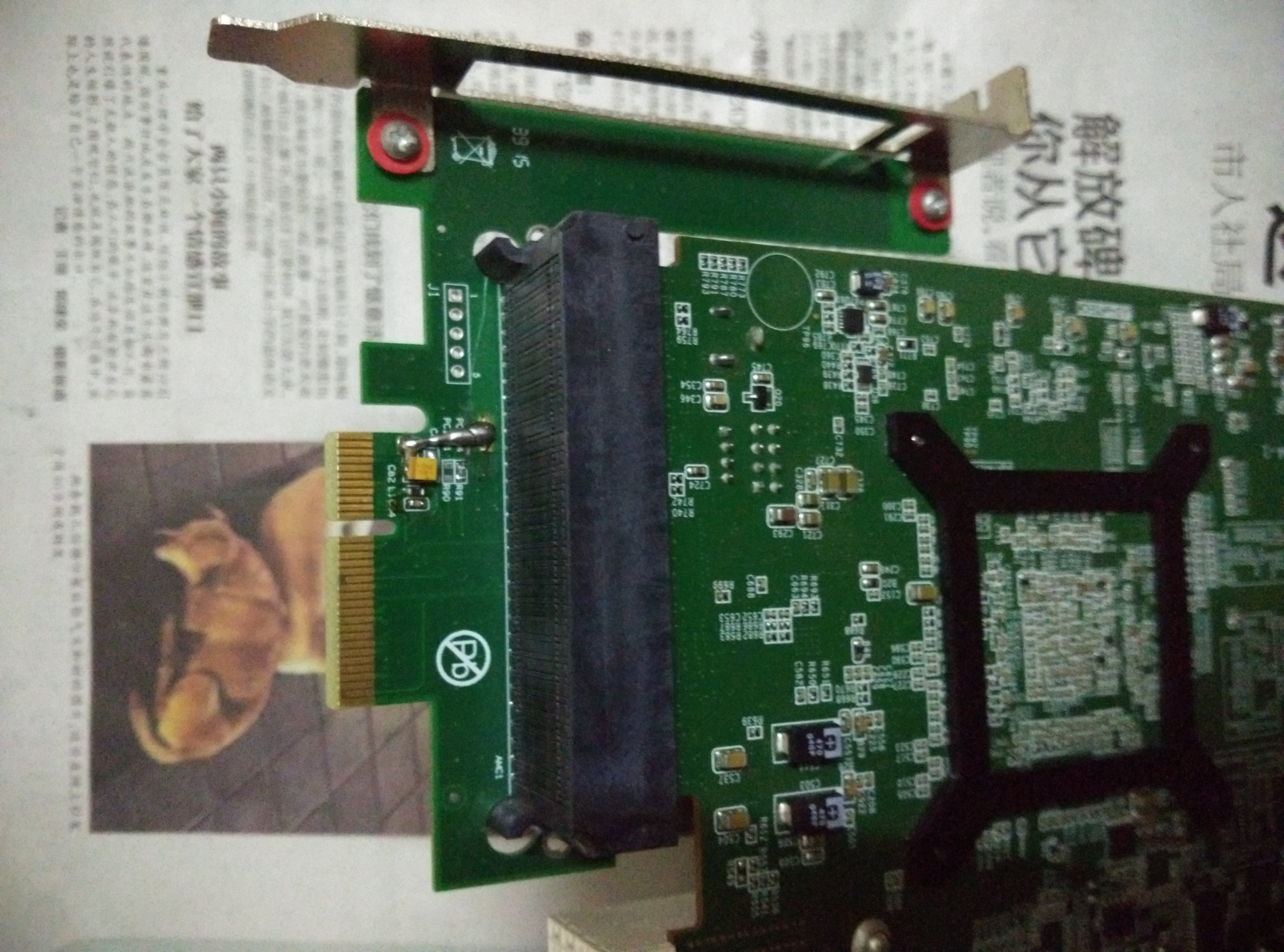

    1. How the PC is interfaced with EVMK2H PCIe? Could you please share the picture of it?
    2. After the above commands, just enter "bootmode" on BMC terminal and share the BMC console log.
    A: We use a AMC to PCIe card ,link with PC.
    A:the log is

    Here is what I do.
    1、After PC restart,via jtag link k2hevm,read the register,LTSSM_EN always 0,and LTSSM_STATE is 0;
    Even though I modify LTSSM_EN  to 1,after a while ,it become to 0.
    2、We disable K2HEVM  itselfs100Mhz clock,only by pc provide clock to pcie module,and then restart the pc,I found that LTSSM_EN  = 0,
    if I modify it to 1,LTSSM_STATE become to 0x11,at this time,I can find the pcie device in pc device manager。But the device can't get system resource.
    Because when PC BIOS enum pcie device don't found it.
    My question:
    1、SO,why the LTSSM_EN  is modified from 1 to 0?
    2、What need to attention and check,let PC enum K2HEVM PCIe device and alloc system resource when first boot?
    For my understanding, Initially power on the PC can detect the DSP PCIe End Point properly. After PC restart the PC can not found PCIe End Point device. Is it correct? If yes, The C66xx PCIe SERDES interfaces are not hot-plug capable. If you restart the PC, you can restart the 66AK2H device also.
    The MCU is control the MUX selection for internal and external PCIe reference clock to SOC. By-default MCU is configured as internal PCIe reference clock, If you using external clock means you need to change the MCU MUX section.
    You able to control the MUX selection via BMC console. Operating the PCIe from the local clock is the standard use case.  All EVMs are tested for this fuctionality prior to shipment from the factory. See below BMC console log for enable/disable PCIe CLK MUX.
