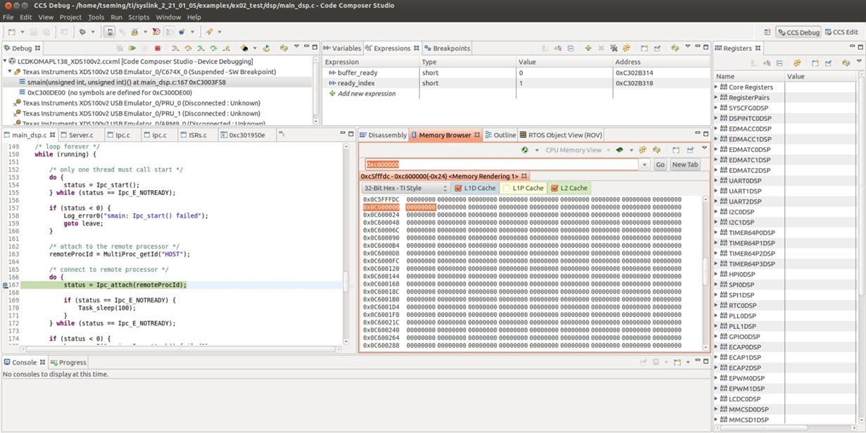

  • Hi Sivaraj,
    Thanks for your prompt reply.
    I followed your method to double check that seemed DSP interrupt (procBuffer) never trigger once finished slaveloader shutdown DSP.
    Could you please provide some hints to me? Thanks a lot
    Here are related printscreen for the reference.
    1. Ipc_attach called ti_sdo_ipc_Ipc_procSyncFinish
    2. View 0xC6000000 for handshaking status
    B.R.
    OC
