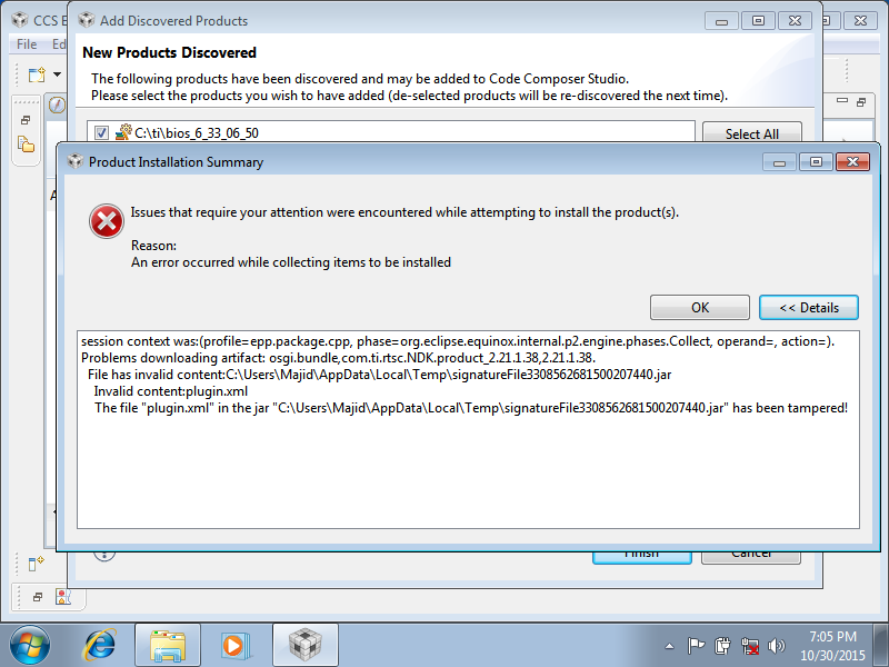

  •   Dear Titusrathinaraj Stalin
    I apriciate your answer. For using FFTW I need to port OpenMP V2 so I upgrade my CCS and MCSDK version.
    MCSDK: 2_1_2_5 -----> 2_1_2_6
    CCS: 5.2 ------> 5.5
    For installing my old version of MCSDK and CCS I studied " BiosMulticoreSDK_2.1_GettingStartedGuide.pdf " and installed as below:
    1) I Installed CCS V5.2 in " c:\ti " directory.
    2) I Installed MCSDK 2_1_2_5 in " c:\Program Files\Texas Instruments" directory.
    3) I copied all MCSDK packages from " c:\Program Files\Texas Instruments " and pasted to " c:\ti " directory.
    4) I ran the CCS and all the things worked correct.
    I repeated all the steps again for installing new version of CCS and MCSDK. When I ran CCS V5.5 an error appeared as below:
    (When importing RTSC)
    What should I do? what is the problem?
    Best Regards
  • I think this is a known issue, uncheck only NDK package the above error and add all other products to CCS.
    Thank you.
