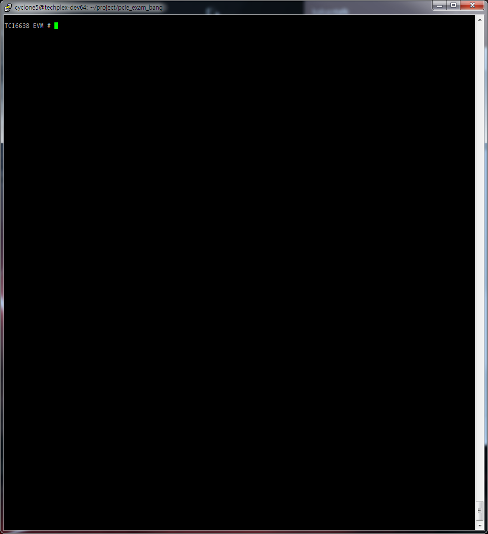

Hello
I recompiled U-BOOT that git tag is K2_UBOOT_2013_01_15.02_02 and I download evmk2h board.
I faced a big problem. U-BOOT don't loads linux kernel without UART.
When I connected UART and Boot the board Linux kernel is loaded fine. but removed UART, Linux kernel is not loaded.
When the board power is up, I have a delay a while, I connect UART to board. I have seen only U-BOOT Console.
actually problem is I can't see any message because UART is connected,  and board power is up, working fine.
What I miss it? follow is my U-BOOT config.

  • Hi Shin,
    I think, you are inserting the UART cable while u-boot booting kernel, it may generate interrupt to stop loading the kernel.
    As we know that auto boot get stop if we press any key on u-boot console.
    Please make sure that is not happening here.
    To confirm this, remove the UART cable, POWER ON the board , leave it for 5 min, then now connect the UART cable and check.
    If still, it hangs at u-boot then we need to check, please let me know if any issues.
  • Hi.
    Thanks your reply. but the issue is not interrupt to stop.
    I tried to boot up removed UART. but didn't boot-up about half an hour. so I tested several time.(1min, 5min, 10min 15min). the result same.
    any other way??
    Regards.
    Shin.
  • Hi k.s.shin,
    Please send us the complete bootlog when the UART is connected and what you got when the UART is not connected.
    Post the screenshot of your UART connection as well as the boot logs.
    For us, though we connect the UART in between, we are able to load the kernel and boot the linux and able to see the boot messages on the screen and then the shell.
  • Hi Shankari
    There is U-BOOT log.
    U-Boot 2013.01 (Apr 14 2014 - 11:49:29)
    I2C:   ready
    Detected SO-DIMM [SQR-SD3T-2G1333SED]
    Reseting entire DDR3 memory to 0 ...
    DRAM:  2 GiB
    NAND:  512 MiB
    Net:   TCI6638_EMAC, TCI6638_EMAC1, K2HK_EMAC2, K2HK_EMAC3
    Hit any key to stop autoboot:  0

    and removed UART power up I wait about 10 min. and I connected UART.
    There is Screenshot
    Printed console only.
    Regards.

  • Hi
    I Tried it. console is U-BOOT console.
    I think It's not H/W issue. because factory U-BOOT was working fine. but U-BOOT update, booting has problem.
    I use large SODIMM Memory, So I have to update U-BOOT, factory U-BOOT doesn't support large SODIMM.
    Regards.
    Shin.
