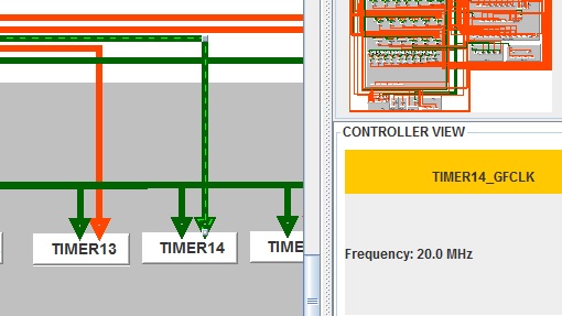

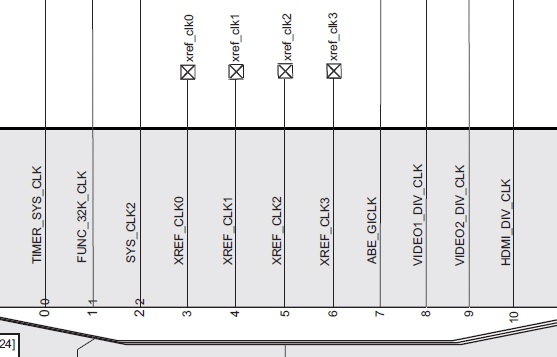

  • Hi Yordan,
    Regarding this 1us increment in counter issue, OMAPL138 uses chained mode to let the timer counters.
    I cannot find this kind of feature in AM5728 GPTimer.
    I checked the AM57GPEVM clocksource is default as below:
    So I can only get a 50ns time period, and it will not get a 1us = 1000ns increment in TCRR even with the prescalers from 2 to 256.
    50ns * 16 = 800ns
    50ns * 32 = 1600ns
    Am I right??
    other clock sources is 22.5Mhz and 32.768Khz. All cannot match the 1Mhz clock with the divisor 2-256.
    In conclusion,
    Is this mean I have to use a external reference clock 0~3 for this application on AM5728 GPEVM? (1us incrementation of TCRR)
    Please advise.
    Thank you.
    Which timer do you use, and what clock frequency do you want to achieve?
    It is true that you can use 20MHz, 22,5MHz or 32,768KHz clock sources, but you can use different path (one that has dividers) to supply the Timer FCLK.
    I.e. I used CTT to configure TIMER4_FCLK to be 2.5 MHz clock. For the purpose I used the ABE_GICLK (supplied by DPLL_ABE) and a 20MHz source on SYS_CLK1. On the path I have 3 clock dividers (Divider_ABE_CLK, Divider_AESS_FCLK & Divider_ABE_GICLK), which I set to 2. So maybe you can choose a different (more appropriate) path to feed your timer fclk.
    Yordan
