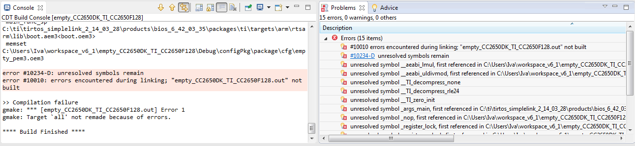

CCS does not build empty example TI-RTOS project when choosing connection through Segger J-Link Emulator.
After fresh import with default XDS100v3 USB Debug Probe, project builds successfully.
When changing Connection back to default, clean build still fails.

  • Hi Anthony,
    I have just tried to do a clean rebuild of the empty TI-RTOS example for CC2650DK in CCS 6.1.1 using "Segger J-Link Emulator" as the connection (by changing Project Properties->General->Main tab-> Connection) and it builds fine for me. Which version of CCS you are using? If you are using an older version it may be good to update.
    If you still can't figure it out, you can try sending me your project.
    Vincent
  • Thank you for a reply
    I'm using CCS 6.1.1.00022 and there are no updates. Fortunately, after a couple more attempts, project was built successfully.
