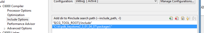

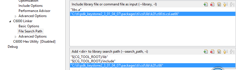

     I have added *.h path into Progect->Properities->Build->C6000 Compiler -> Include Options; And the CSL libiary also is added into  Progect->Properities->Build->C6000 Linker , As following in attachement:

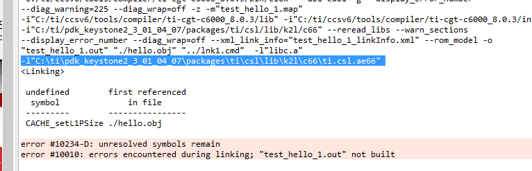

However, when I builded a program, as followed, which uses the CSL function.

The CCS showed the following errors:
From the complier script, I can know that CSL libiary has been included. So the error really confused me.
