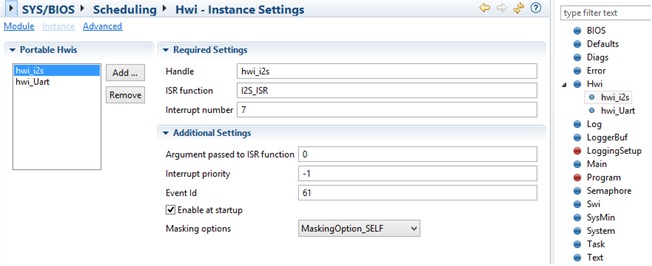

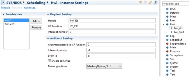

Then I copy the same code into I2S_ISR() and in app.cfg, following settings on app.cfg
UART_ISR Event # 69 CPU interrupt #5
I2S_ISR Event #61 CPU interrupt #7
Also in McASP initialisation, I allow TX interrupt
mcaspRegs->XINTCTL = 0x00000020;
Even if I interchange the CPU interrupt so that McASP has a higher priority than UART and is uninterrupted (BTW UART for me works fine)..... still nothing on the TX line!!! the XBUFn shows the value that I have written on it in my code. Please see my project attached. It is located in C:\ti\WorkspaceI2S Master.rar

  • It started working after i changed the ISR conditions. I changed it to the following
    if (mcaspRegs->XSTAT & 0x00000100)
    		Log_info1("TX underrun : [%x]", mcaspRegs->XSTAT);
    		mcaspRegs->XSTAT = 0x00000101;
    		while (mcaspRegs->XSTAT & 0x00000001)
    		while (mcaspRegs->XSTAT & 0x00000100)
    else if ((mcaspRegs->XSTAT & 0x00000020)) //XBUF ready { if (mcaspRegs->XSTAT & 0x00000040) //Start of frame { mcaspRegs->XBUF7 = sample_left; mcaspRegs->XSTAT = 0x00000040; } else { mcaspRegs->XBUF7 = sample_right; mcaspRegs->XSTAT = 0x00000010; } mcaspRegs->XSTAT = 0x00000020; }
    Instead of using if (check start of frame bit) else if ( check Last slot bit) ;... I made it if ( check start of frame) ...and else.
