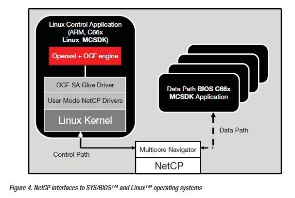

i try to share NetCP between sys/bios program on core 1-7 and linux c6x on core 0 in c6678 EVM similar this :

  • Hi, Ebi,
    The example can not be run as is when there is Linux running. The example assumes DSP owns all resources, but when Linux running, it also configures NetCP. You will need to modify the example so it is not running as a master.

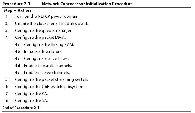

    from NetCP UG initialization procedure is:
    you are right, i debug sys/bios code (PA_multicore) and i see first problem is in cppi_qmss_mgmt.c :: Init_Qmss (Void) :: Qmss_init (LLD for Link RAM config)

  • Hi, Ebi,
    It is not memory configuration. Linux downloads the NetCP firmware. When running PA_example, the firmware will be downloaded again by DSP core 0 which will wipes out what Linux has done. Linux statically takes several indexes in PA entries which the example should avoid. Also, Linux configures DMA which DSP shouldn't redo it.
    The roadmap of Linux-c6x? or C6678? There will be no roadmap for Linux-c6x because we don't see much activities on it. C6678 is TI Keystone-I family and TI has Keystone-II devices. One of the KS2 devices is K2H12 which has 4 ARM cores and 8 DSP cores. The kernel on KS2 and Sitara family will be the Linux kernel on ARM core (SMP Linux in case of multiple ARM cores) instead of ucLinux on C6678.
