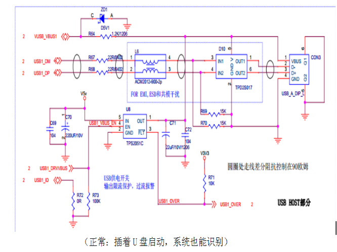

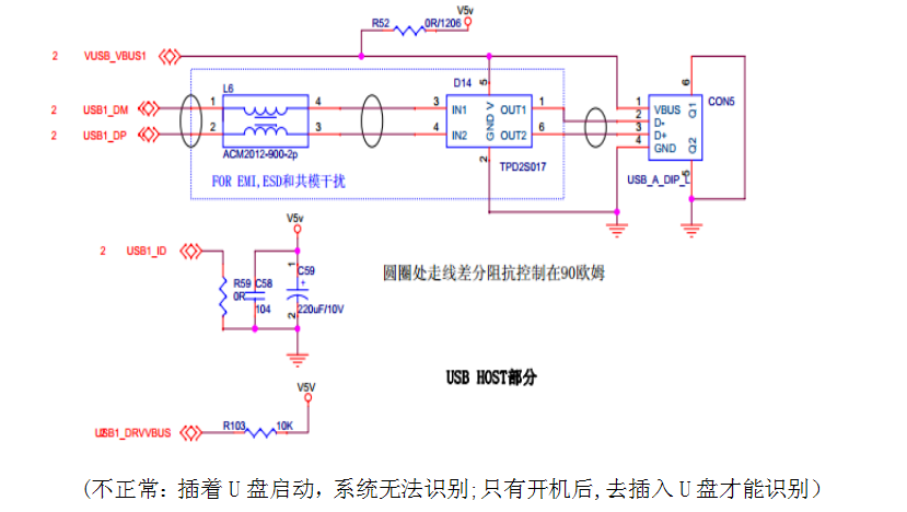

am335x usb1 host wince7, before the wince7 system booting up with inserting the u disk ,  the wince7 system can't  identify .but if  after the wince7 system boot up,  then insert the udisk , it is normal .  for solving this problem ,we debug the information ,as follow:

I think,the importance error information above,just
 m_portBase->DEVCTL = 99
USBInterruptThread: IntrUsbValue=0x4, IntrRxValue=0x0, IntrTxValue=0x0
PID:00400002 TID:036D0012 +CQueuedPipe(Control)::AbortTransfer - lpvCancelId = 0x9f509500
PID:00400002 TID:036D0012 -CQueuedPipe(Control)::AbortTransfer - lpvCancelId = 0x9f509500, returning HCD_REQUEST_STATUS 1
PID:00400002 TID:036D0012 +CPipe(Control)::IsPipeHalted
PID:00400002 TID:036D0012 -CPipe(Control)::IsPipeHalted, *lpbHalted = 0, returning HCD_REQUEST_STATUS 1
please help me to solve this problem
                                                          above,it is normal ,don't go wrong
                                                this circuit go wrong
