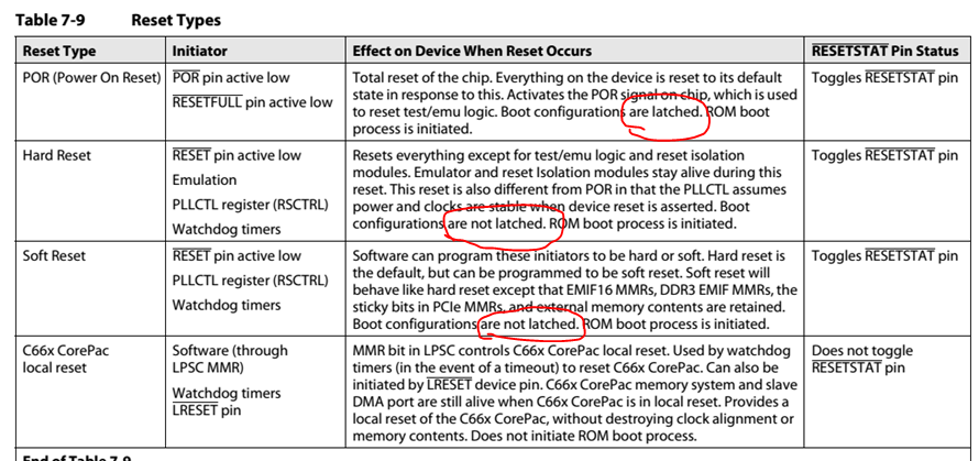

Hi all,
It's about RESET and DEVSTAT latching.
Look, the datasheet :for hard reset and soft reset,the DEVSTAT pins are not re-latched. and the boot mode field is writable(I have verified), so I can
modify the boot configuration field in DEVSTAT,and then trig the reset by writing the RSTCTL and RSTCFG register.
But i found the DEVSTAT is still re-latched after both hard or soft reset ! It is not acting as the Datasheet descripts.
Can you tell me why?
Here is my code, Please point out my mistakes? Thank you in advance!

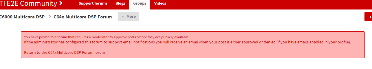

    Cuz it said my post  was not successfully posted, so I tried several times. sorry .
    I don't know why.I thought there was problem in C66 forum. The issue is urgent. So I went to C64 forum for help, too .
    Plz tell me what happened to my account ,thanks !

  • Hi Raja,
    Actually,I had tried both the two sequence before my post here.
    1. Please lock the boot configuration register after DEVSTAT value is modified. Then follow the reset sequence.
    I have locked as you sequence but DEVSTAT still re-latched.
    " Note: Make some delay if needed after locking boot configuration register."
    I have make delay in a for loop: 1000 asm(NOP 5);I think it is enough.
    Still relatched after execute the " *RegPtr &= 0xFFFEFFFF;" //RSTCFG trig soft reset
    Can you have a try and make sure the chip is really works as "not re-latch". I found there are a lot of mismatch between the Datasheet and the device action.

  • Hi Frank,
    We have reproduced the issue already. This issue has been observed in all keystone I devices. We have escalated this to SoC design team and awaiting for their confirmation and workaround if possible.
    Thank you for your patience.

  • Hi Frank Deng,
    Please refer the response by Rahul on below new thread ,
    https://e2e.ti.com/support/dsp/c6000_multi-core_dsps/f/639/t/470512
