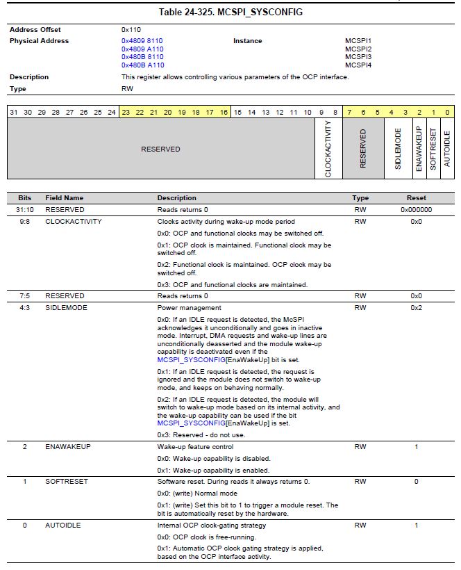

Starting to look at developing a MCSPI driver for the AM5728.  I have processor_sdk_rtos_am57xx_2_00_00_00 which includes pdk_am57xx_1_0_0.  In the packages\ti\csl folder I find the file cslr_mcspi.h which seems to define the registers and fields for the MCSPI, but starting with SOFTRESET it does not seem to match the TRM, AM572x_SR1.1_TRM_vD.pdf.
For example, from the cslr_mcspi.h
/* HL_SYSCONFIG */
#define CSL_MCSPI_HL_SYSCONFIG_IDLEMODE_MASK                    (0x0000000CU)
#define CSL_MCSPI_HL_SYSCONFIG_IDLEMODE_SHIFT                   (2U)
#define CSL_MCSPI_HL_SYSCONFIG_IDLEMODE_RESETVAL                (0x00000002U)
#define CSL_MCSPI_HL_SYSCONFIG_IDLEMODE_SMARTIDLEWAKEUP         (0x00000003U)
#define CSL_MCSPI_HL_SYSCONFIG_IDLEMODE_FORCEIDLE               (0x00000000U)
#define CSL_MCSPI_HL_SYSCONFIG_IDLEMODE_NOIDLE                  (0x00000001U)
#define CSL_MCSPI_HL_SYSCONFIG_IDLEMODE_SMARTIDLE               (0x00000002U)
#define CSL_MCSPI_HL_SYSCONFIG_RSVD_MASK                        (0xFFFFFFF0U)
#define CSL_MCSPI_HL_SYSCONFIG_RSVD_SHIFT                       (4U)
#define CSL_MCSPI_HL_SYSCONFIG_RSVD_RESETVAL                    (0x00000000U)
#define CSL_MCSPI_HL_SYSCONFIG_RSVD_MAX                         (0x0fffffffU)
#define CSL_MCSPI_HL_SYSCONFIG_SOFTRESET_MASK                   (0x00000001U)
#define CSL_MCSPI_HL_SYSCONFIG_SOFTRESET_SHIFT                  (0U)
#define CSL_MCSPI_HL_SYSCONFIG_SOFTRESET_RESETVAL               (0x00000000U)
#define CSL_MCSPI_HL_SYSCONFIG_SOFTRESET_RESETDONE              (0x00000000U)
#define CSL_MCSPI_HL_SYSCONFIG_SOFTRESET_NOACTION               (0x00000000U)
#define CSL_MCSPI_HL_SYSCONFIG_SOFTRESET_SOFTRESET              (0x00000001U)
#define CSL_MCSPI_HL_SYSCONFIG_SOFTRESET_RESETONGOING           (0x00000001U)
#define CSL_MCSPI_HL_SYSCONFIG_FREEEMU_MASK                     (0x00000002U)
#define CSL_MCSPI_HL_SYSCONFIG_FREEEMU_SHIFT                    (1U)
#define CSL_MCSPI_HL_SYSCONFIG_FREEEMU_RESETVAL                 (0x00000000U)
#define CSL_MCSPI_HL_SYSCONFIG_FREEEMU_EMUDIS                   (0x00000001U)
#define CSL_MCSPI_HL_SYSCONFIG_FREEEMU_EMUEN                    (0x00000000U)
#define CSL_MCSPI_HL_SYSCONFIG_RESETVAL                         (0x00000008U)

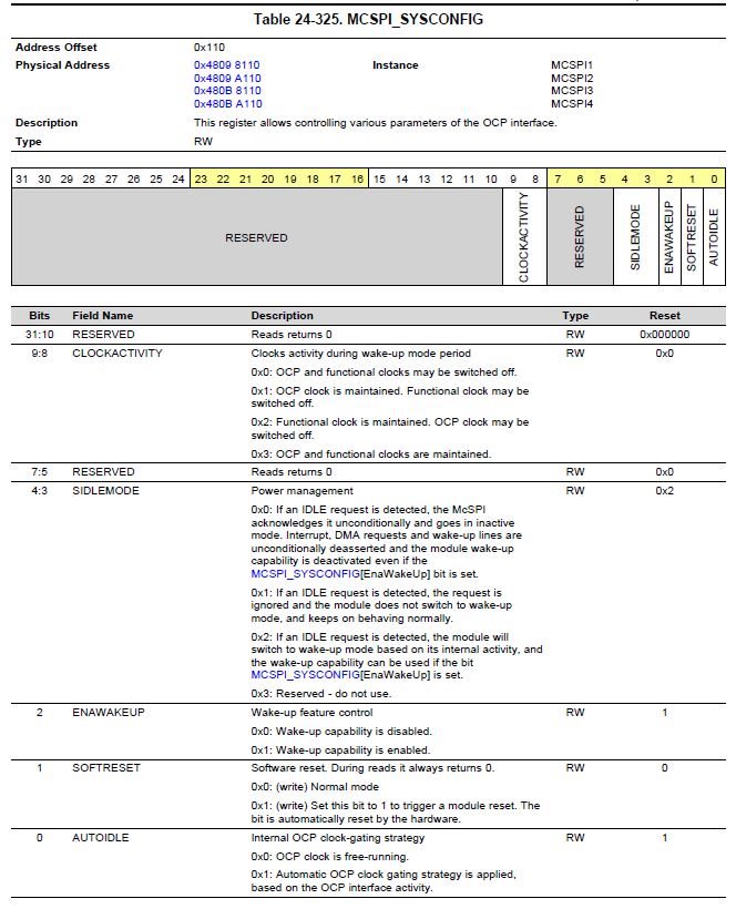

That tells me that SOFTRESET is bit 0.
From the TRM,
The other fields also don't agree.  I feel like cslr_mcspi.h is not the correct file for the AM5728.

  • Hi Chris,
    I think your not looking at the correct SYSCONFIG register in the SPEC. The McSPI spec has a MCSPI_HL_SYSCONFIG and MCSPI_SYSCONFIG. The CSL code you have provided is for the HL_SYSCONFIG register and the TRM screenshot is for the SYSCONFIG register. Hope this clarifies the issue.  Also as you noticed already, we have provided a McSPI LLD driver in the release that you can use for your application.
    I will take a look at the mutlichannel implementation in the LLD and let you know if the driver can support your usecase.
    Rahul
    PS: I have confirmed that both the bits can be used to reset the McSPI module.
  • Rahul,
    Thanks for the clarification on the HL_SYSCONFIG vs SYSCONFIG.

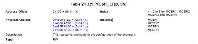

    We also noticed something else concerning with regards to "channels". If you look at the TRM, the note in Figure 24-79 (our use case) says "In this case m=[1,3]." That implies to me that if I want to use a MCSPI module with two chip selects, I can only do so on modules 1 and 3. That could be a big limitation for us as those pins might not be available depending on what other resources we are using (ie GPMC).
    To re-iterate our use case, we'd like to use 2 MCSPI Modules, MCSPI1 and MCSPI2, each with 2 chip selects. As we are doing the board schematics now, we need to know if this is a possibility.

  • I think I'm a bit closer to the answer now that I realize the text in the TRM is misleading.  For example,
    It says for the Index "x = 0 to 3 for MCSPI1, MCSPI2, MCSPI3, MCSPI4"  If it said "x = 0 to 3 for the channel per MCSPI Instance" that would have been more clear to me.
    You're absolutely correct.  I filed a ticket to get that fixed.  Thank you for mentioning it.
