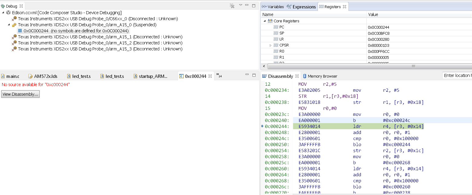

  • I am able to boot your application on the K2E EVM and do see the ARM core executing the BootLEDtest example that you had provided.
     Please refer to the build files in the attachment provided here:
    https://e2e.ti.com/cfs-file/__key/communityserver-discussions-components-files/791/BootLEDtest.piz
    In order to boot the application, I used the assembly code that you provided and created an application binary by creating a project in CCS with the GNU ARM Compiler for the A15 core. Refer to the CCSProject directory in attached folder. I had to modify the assembly code slightly by declared the bootLEDtest code as global function so that I can call it from my main( ) function. The modified main.c, led_test.s and startup_ARMCa15.s assembly files are attached.  The startup_ARMCa15.s is necessary when using bare metal code with Linaro tool chain to configure the A15 core before entering main. It initializes ISR table, core interrupt handlers, NEON extensions before branching to main

    To confirm that the image booted correctly, I connected to A15_core0 after the boot completed and loaded the symbols to confirm the PC is in the bootLEDtest function.

  • Thanks for the clarification Mitch.
    Here is a snapshot for your reference, of the ARM core executing the application on the K2E EVM after booting from SPI flash.
