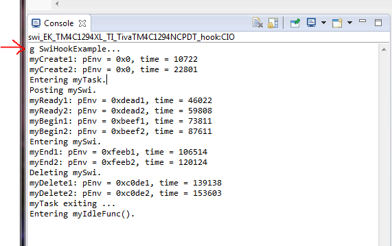

When I run a sample project of BIOS user guide on Tiva-C 1294 LauchPad, RTOS 2.14, the console has incomplete content. Please see the picture below.
The console should have these:
myRegister1: assigned hookSet Id = 0
myRegister2: assigned hookSet Id = 1
Starting SwiHookExample...
The code has no problem because these contents are shown in ROV SysMin. I don't know what configuration can has these show up.

  • Hi Robert,
    I expect you have SysMin as your System Provider. You can confirm by looking in the .cfg file for the following:
    System.SupportProxy = SysMin;
    With SysMin, the System_printf output is stored in an internal buffer until System_flush or BIOS_exit (and you have BIOS_exit set to flush the output) is called. If the internal buffer is full, the new data over-writes the old data. You can fix this by
    1. Making the internal buffer bigger (SysMin.bufSize = 2048; // default is 1024).
    2. Call System_flush periodically
    3. Output less data
    Note: when CCS is attached and you are using SysMin, the System_flush might cause CCS to halt the target to read the data. So if real-time is important, I'd go for option 1 or 3.
    There is a nice write-up of the different System Providers in the TI-RTOS User Guide.
