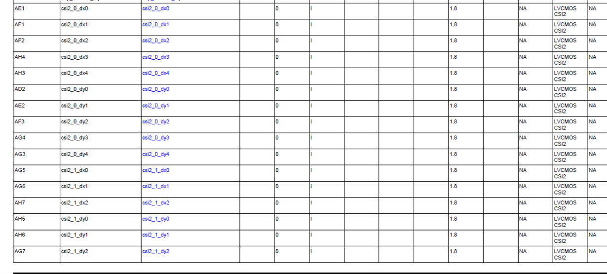

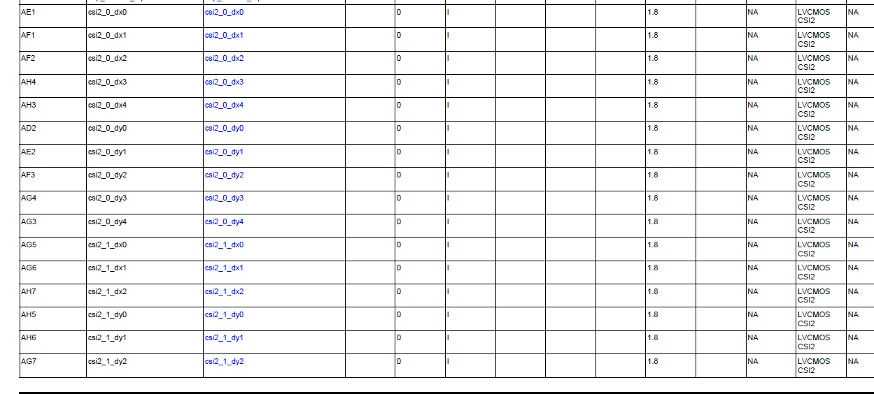

  • hi Manisha,
    We did consider pinmux could be the problem. First we check DM and found:
    these pins have only one mux mode, and we cannot find PAD_CONF regs for them in Control module reg list in TRM. Could we missed something? pls help
  • Okay, I see now that on DRA72x the CSI2 pins are dedicated so there are no pinmux needed for them.

  • Another check on DT settings - the lane polarities are all set to be inverted. Is that on purpose?
  • hi manisha
    the lane polarities are set according to hardware design.

     Can you look into following things -
    • In csi2_ctx_config() the context is set with a virtual channel id.
      The virtual channel id comes from DT:
    csi2_sensor_1: endpoint {
                    reg = <0>;    ç in this case 0
                    clock-lanes = <1>;
                    data-lanes = <0 2 3 4>;
                    remote-endpoint = <&csi2_0>;
    Verify that your sensor is sending data tagged with Virtual Channel id 0.
    • in pix_proc_config() , currently pixel extraction is hard coded and packing parameters for an 8 bits source.
    You might want to set Extraction to either 10 bits MIPI or 10 bits linear, and also set Packing to 16 bits.
