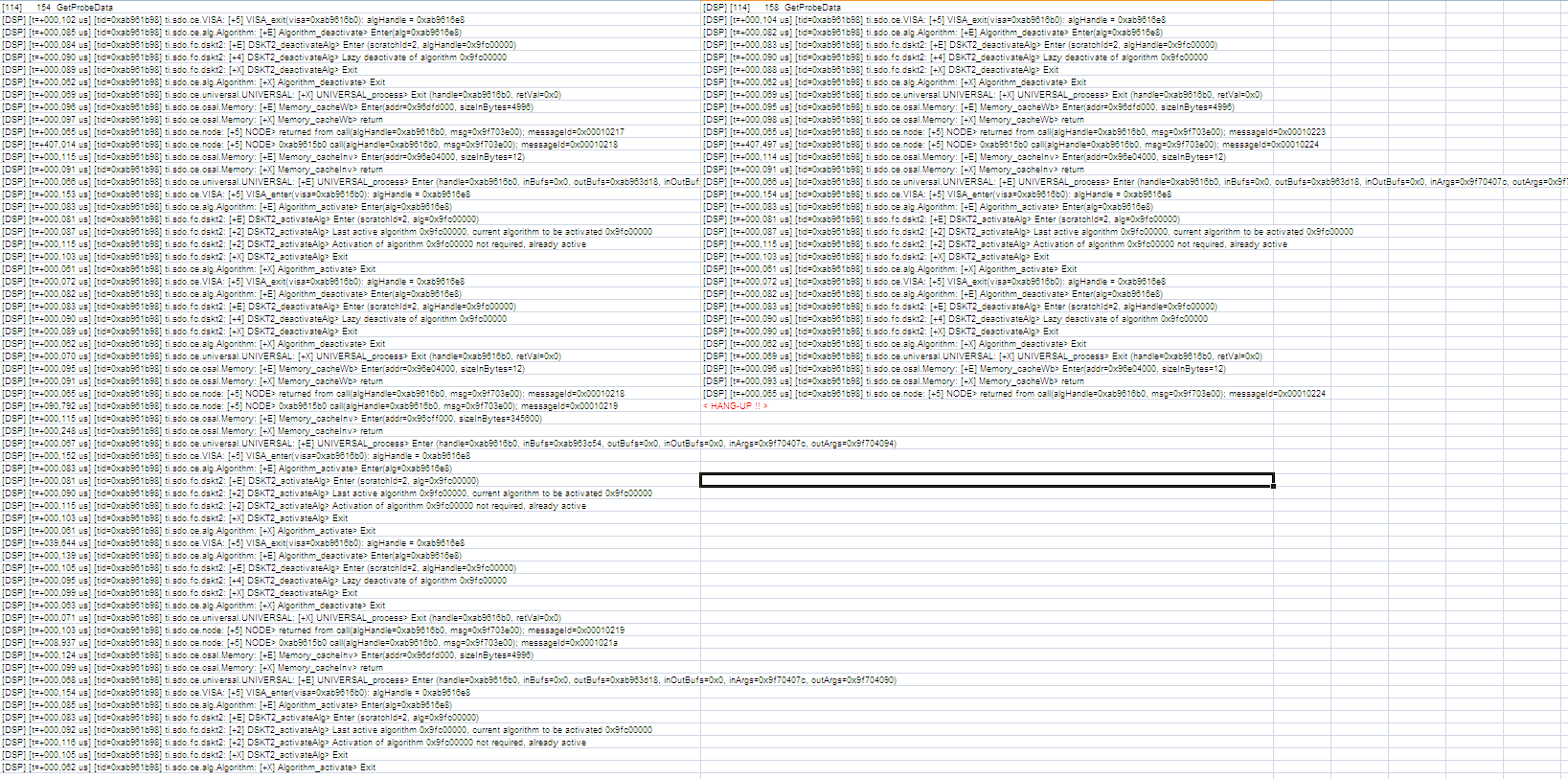

CE_DEBUG=2 log
Left: OK
Right: Hang-up
Always it seems to be stopped before entering the DSP-function1.
If it seems there is a problem with the DSP-function1, I thought to hang up in a function.
I think there is a problem with the ARM and DSP I / F?
Or if there is a problem with the DSP-Function, you think that may occur?
  • Hi Hideki,
    The Codec Engine trace you have shown is saying that it successfully handled the previous algorithm 'Process' call and there is no other new call into any algorithm (i.e. DSP-Function). It is possible something broke in the ARM-to-DSP interface in C6Accel so the next DSP-Function call is not initiated, or maybe the ARM-side application never initiated the call into C6Accel. You may want to lean on the forum for DM8148 if you have questions regarding C6Accel and the EZSDK.
