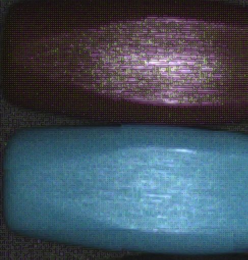

  • Ah, thank you for the information.  I think the documentation and examples could be much more explicit on the component order.  I had assumed a 32 bit little endian addressing scheme like the rest of the dsp which led to my confusion.
    I am now getting previewer results with good looking luma, but the chroma is wacky.  (this is from CCS display, after separating components from previewer output)

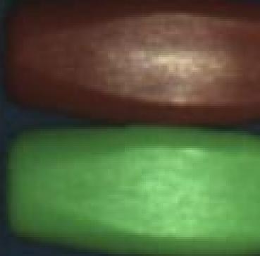

    When I take the same raw bayer image and run it through a simple demosaic, I get this (downres &  jpeg):
    I left the csc0:2 registers in their default states.
    RGB blend matrix is identity (rgb_mat1, 3, & 5 = 0x100)
    Only stage enabled in previewer is cfa interpolation.
    CFA register is 0x28 for both vert & hor gradients (taken from example).
    I pulled the cfa coefficients from the psp_bios_prev_st_on_the_fly example.  I did notice that the cfa array length is specified as 760 in spru977, but the array used in the example is size 576.  Is this any issue?

  • I tinkered with things and finally achieved a true color image result.
    First, I used the color space conversion settings from the ti example.
    I also changed the order of the cfa constants.  From spru977, I had assumed that the input bayer pattern was as above, with 0,0 being in the upper left.  Either this is incorrect, or the previewer example that I took the cfa constants from was inconsistent with the document.  Either way, I have my image now.
  • [0,0] is upper left.
    Please note that if your starting color is not same as the one in our reference, then the reference parameters don't work properly.
