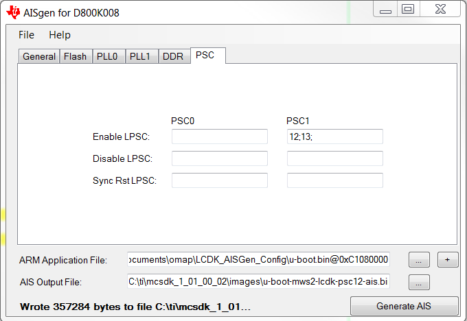

  • I was able to produce output on UART1 TX. I changed the bootloader to initialize UART1 (but not set it as console). See changes listed below. I also had to enable LPSC PSC1 12 when generating the AIS bootloader image. Perhaps not all of the changes were required (e.g. pinmuxing is also done in the kernel board init).
    It seems most of these changes should live in the kernel board initialization or serial driver. Does anyone have insight on where the best place for these changes to be made?

  • Dear MattS,
    Sorry for the delayed response on this.
    Glad to hear that you able to resolve the problem.
    Yes, we can also configure any peripheral support in u-boot and should not touch that peripheral part in kernel, then it will be fine.
