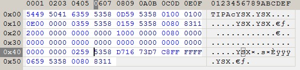

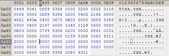

  • We need a dump of the first 32 bytes of your boot image (0x00-0x20 of the flash).  There is obviously an AIS command in that region that is causing different behavior on rev1 parts versus rev2 parts. Can't think what it could be, but we will know it when we see it.
    Regards, Daniel
  • I'm assuming that "boot image" means dspais. An output of the command "od -cx dsp-spi-ais.bin" follows. Note that I think we have not changed this file from the original distribution that came with the development kit. (I can't find a CCS project for it on my system or in our repository.) The spi-flash-writer project (dsp) says that the offset for dspais is 0, so I'm assuming it is stored at offset 0 in the SPI flash.
    0000000   T   I   P   A   c   Y   S   X  \r   Y   S   X 001  \0 001  \0
            4954 4150 5963 5853 590d 5853 0001 0001
    0000020  \0  \0  \0  \0 004   Y   S   X 001   Y   S   X  \0  \0 001 200
            0000 0000 5904 5853 5901 5853 0000 8001
    The 3rd through 5th words of the AIS image are setting the prescalar of the SPI module to 0, which is not a supported setting of the SPI module.  The prescalar should be 0x2 or higher (the ROM defaults the value to 0x0E).  Why this is causing the exact timing issue you are seeing, I can't say exactly.  As a workaround, try updating the dspais image so that the fifth word of the image (at offset 0x10) is not 0x00000000, but rather 0x0000000E.  Alternatively, you can remove the third, fourth, and fifth words entirely.  Then reflash the image to the SPI flash and try booting.
    We will need to report this issue with the dspais file to the appropriate team, assuming that the workaround mentioned above fixes the problem.
    Regards, Daniel
  • I found the dspubl project and even found where the prescaler was set. I changed it and rebuilt, but the generated code was .out, not .bin. I downloaded the AISgen tool. That is where things started to fall apart. The instructions said to type
    hexgen -romid D800K001 -seqread -crc 1 -spiclk 0 -appln <PATH to ubl-spi.out or ubl-nand.out> -output <dsp-spi-ais.bin or dsp-spi-ais.bin>
    in the directory of the installation.
    I tried that, but "hexgen" is not recognized. If the files in that directory, I tried "HexAIS_OMAP-L137.exe", which seemed like the likely choice. It does not understand the "-romid". I read the help and formatted the command:
    HexAIS_OMAP-L137.exe -otype binary -o dsp-spi-ais.bin <input file>

  • My intention was not for you to rebuild the dsp-spi-ais file, but rather just edit the binary you already had.  That hexgen command line is from the tools that were originally distributed for the version 1.0 ROM.  The HexAIS tool is distributed for the new ROM revision.

    I would still recommended simply editing the binary you have as indicated in the previous post.
    Regards, Daniel
  • I understood your intent, but I'm not sure what tool to use to edit the .bin file. Is your suggestion that I put a breakpoint in the spi-flash-writer code and edit the buffer after I've read the record? If so, is there a CRC or checksum that I would have to edit? I would certainly have to edit the buffer again when I run the verify step (which I've modified to perform a real verify).
  • Use a hex editor. See here for a list of available programs.  I personally use TinyHexer on Windows.
    Regards, Daniel
  • Didn't work, but I'm comparing the data to the hex dump I gave you. There is byte swap going on, so that the SPI bytes are 0x5449, 0x5041, etc. The last byte is 0x0E, but should it be the next-to-last-byte?
    The SPIFMT0 is still 0x00020008 after the processor hangs, suggesting that the prescaler is still 0.
  • In byte order, an AIS file will appear as follows:
    So based on your earlier post, yes I believe there is some ordering issue you may need to overcome (depending on what program you are using to edit and view the binary contents). Note that the above was generated using the ini data I provided in the earlier post, in conjunction with the HexAIS tool for OMAP-L137.
    Regards, Daniel
  • Okay, thanks. I reproduced that and the SPI clock stays a normal speed. Unfortunately, the code still doesn't boot. 'm not sure if I have a similar problem with the armubl or if the reads from the SPI are giving me corrupt data. I'm working on that. (If you know of any similar magic byte for armubl, please let me know.)
