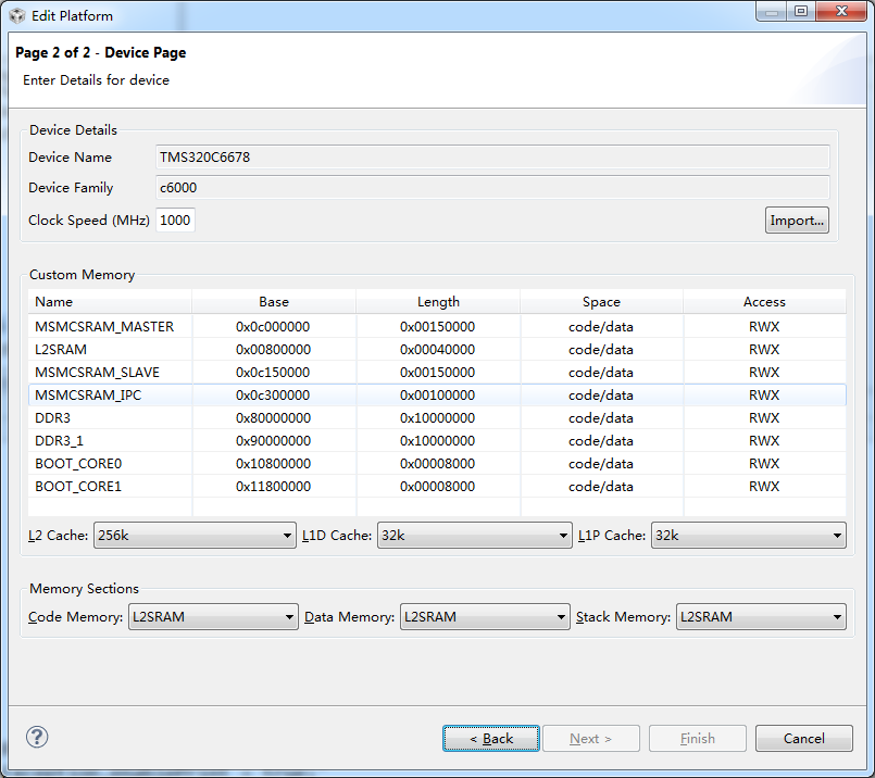

I need to achieve SPI nor boot(2 cores are used) on TMDSEVM6678L
first I managed to write the master_core code, it works well both on emulator and by SPI nor boot
Before trying the slave_core code, I need to fix the  _c_int00, write its address on the end of each core's SRAM and write IPC interruption.
In order to fix  _c_int00, I modified the platform information :(add BOOT_CORE0 BOOT_CORE1)
and .cfg file with the reference of SYS/BIOS FAQs
Program.sectMap[".myboot { boot.ae66< boot.oe66> (.text) }"] = new Program.SectionSpec();
Program.sectMap[".myboot { boot.ae66< boot.oe66> (.text) }"].loadSegment = "BOOT_CORE0";
Program.sectMap[".myboot { boot.ae66< boot.oe66> (.text) }"].loadAlign = 0x800;
although there is no error during the build, as soon as I connect core0 with emulator and load the program, it runs automatically and abort with the console information as follow

Exception at 0x1080e1b8
EFR=0x2 NRP=0x1080e1b8
Internal exception: IERR=0x8
Opcode exception
ti.sysbios.family.c64p.Exception: line 255: E_exceptionMin: pc = 0x0c0c590a, sp = 0x00000000.
To see more exception detail, use ROV or set 'ti.sysbios.family.c64p.Exception.enablePrint = true;'
xdc.runtime.Error.raise: terminating execution
I am out of ways to figure out the specific fault
