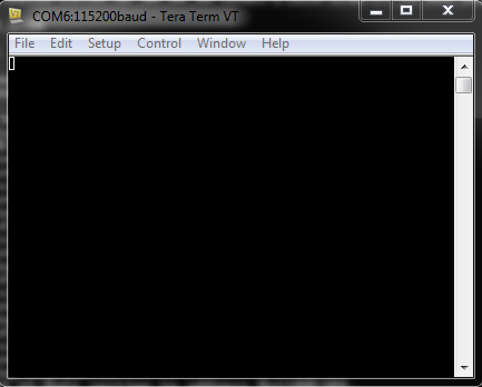

Attached 2 screenshots with tera term

  • Hi Shankari,
    We are seeing the "BOOTME" message when booting from UART2. However, there is no serial output when we try to boot from NAND, baud rate 115200.

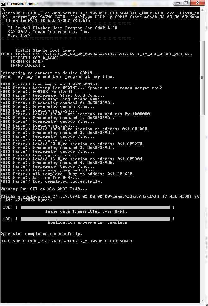

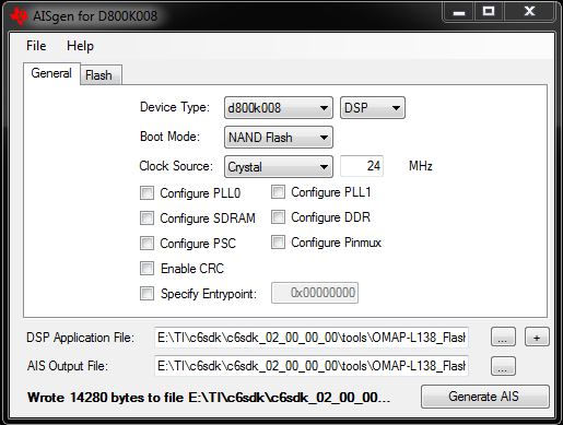

    So, we tried reflashing the demo code. We used AISgen.exe to create demo.ais from demo.out, in the C6748 StarterWare software package (C6748_StarterWare_1_20_04_01\binary\c674x\cgt_ccs\c6748\lcdkC6748\demo\Release\boot.out). We then set S1 to 01010000, and flashed this to the LCDK using the command:
    "sfh_OMAP-L138.exe -flash_noubl -flashType NAND -targetType C6748_LCDK -p COM6 demo.ais"
    The flashing operation completed successfully, and when we tried to boot from NAND again (setting S1 to 01110000) we still saw no output in the serial terminal program.
    Is this the correct demo program that ships with the board? Is there some other program we should be flashing instead to see some output in our terminal program?
    Thank you
    E:\C6748_StarterWare_1_20_04_01\binary\c674x\cgt_ccs\c6748\lcdkC6748\bootloader\ Release>sfh_OMAP-L138.exe -flash_noubl -flashType NAND -targetType C6748_LCDK -p COM6 demo.ais ----------------------------------------------------- TI Serial Flasher Host Program for OMAP-L138 (C) 2011, Texas Instruments, Inc. Ver. 1.67 ----------------------------------------------------- [TYPE] Single boot image [BOOT IMAGE] demo.ais [TARGET] C6748_LCDK [DEVICE] NAND [NAND Block] 1 Attempting to connect to device COM6... Press any key to end this program at any time. (AIS Parse): Read magic word 0x41504954. (AIS Parse): Waiting for BOOTME... (power on or reset target now) (AIS Parse): BOOTME received! (AIS Parse): Performing Start-Word Sync... (AIS Parse): Performing Ping Opcode Sync... (AIS Parse): Processing command 0: 0x58535901. (AIS Parse): Performing Opcode Sync... (AIS Parse): Loading section... (AIS Parse): Loaded 19808-Byte section to address 0x11800000. (AIS Parse): Processing command 1: 0x58535901. (AIS Parse): Performing Opcode Sync... (AIS Parse): Loading section... (AIS Parse): Loaded 1364-Byte section to address 0x11804D60. (AIS Parse): Processing command 2: 0x58535901. (AIS Parse): Performing Opcode Sync... (AIS Parse): Loading section... (AIS Parse): Loaded 20-Byte section to address 0x118052F0. (AIS Parse): Processing command 3: 0x58535901. (AIS Parse): Performing Opcode Sync... (AIS Parse): Loading section... (AIS Parse): Loaded 16-Byte section to address 0x11805304. (AIS Parse): Processing command 4: 0x58535906. (AIS Parse): Performing Opcode Sync... (AIS Parse): Performing jump and close... (AIS Parse): AIS complete. Jump to address 0x11804620. (AIS Parse): Waiting for DONE... (AIS Parse): Boot completed successfully. Waiting for SFT on the OMAP-L138... Flashing application demo.ais (1127872 bytes) 100% [ ¦¦¦¦¦¦¦¦¦¦¦¦¦¦¦¦¦¦¦¦¦¦¦¦¦¦¦¦¦¦¦¦¦¦¦¦¦¦¦¦¦¦¦¦¦¦¦¦¦¦¦¦¦¦¦¦¦¦¦¦ ] Image data transmitted over UART. 100% [ ¦¦¦¦¦¦¦¦¦¦¦¦¦¦¦¦¦¦¦¦¦¦¦¦¦¦¦¦¦¦¦¦¦¦¦¦¦¦¦¦¦¦¦¦¦¦¦¦¦¦¦¦¦¦¦¦¦¦¦¦ ] Application programming complete Operation completed successfully.

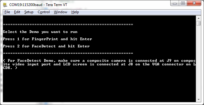

    We ship LCDK board with the following flashed binary which has both finger print sensor demo binary and facedetect binary.
    C:\ti\c6sdk_02_00_00_00\demos\flash\lcdk\IT_IS_ALL_ABOUT_YOU.bin
    FYI: In newer LCDK board, you can't see the finger print sensor due to obsolete sensor.
    Did you install the C6SDK ?
    Refer to the following TI wiki pages.
    Here I flashed that binary and able to get the expected output.

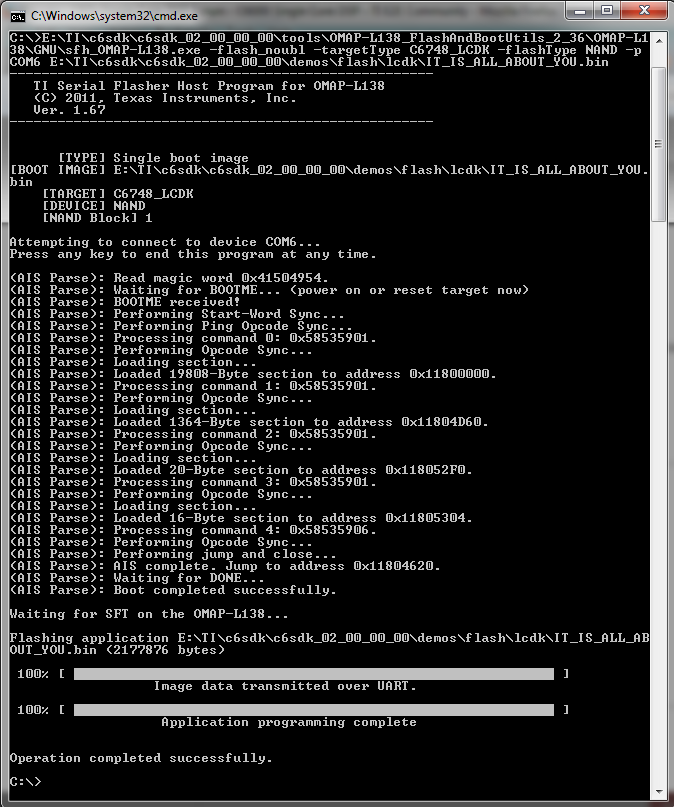

  • Good morning!
    From the beginning we didn't receive any output from the board. That's why we try to reflash demo program.
    Yes, we did.
    Following for your steps
    dip: 01010000
    dip: 01110000
    So, as You can see - no output.
    Any suggestions?
    Thank You in advance.
    Dmitriy.
