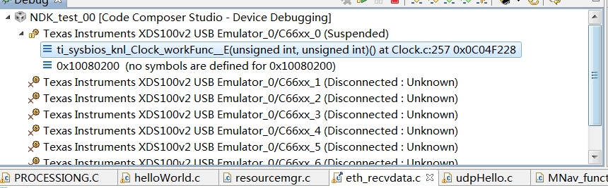

i am using AMC2C6670 to test ndk helloworld example and have added my project to this skeleton code.
but i encountered a problem while running it.
How can i deal with it...thanks...

    Did you find which line causing this problem ?
    Able to stop at main() while loading the code ?

    it didnt sure which line cause it.I have tested several times but it still can't be certain.
    it can stop in main() and receiving UDP packet is OK.

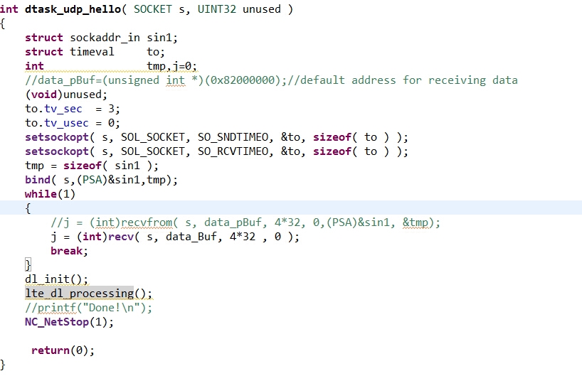

    i want to receive data from PC and execute the data processing which is in a for-loop and needed to be processed hundred times.
    I didnt change the code in NDK except the udphello.c.i've add a processing code to it.That's all.
