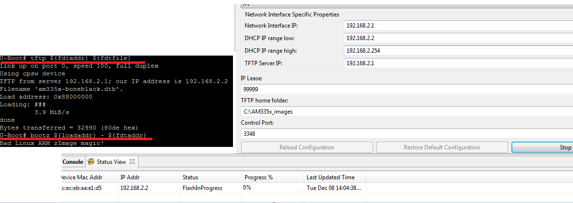

i have BBB with installed on it Debian. But for my work i need to use PRUs core. For this reason i downloaded SDK+pruAddon+CCS from TI.
Then, i completed next steps:
1) "Configure a Linux Host" on my VirtualMachine and installed SDK
2) Installed pruAddon+CCS

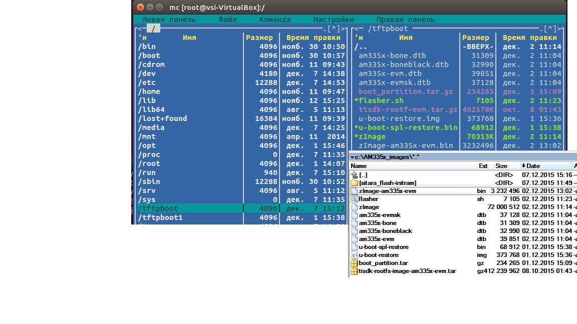

3) "Configure a PRU" and checked files .confige and tisdk_am335x-evm_defconfig.
4) Run "make all" from SDK dir.

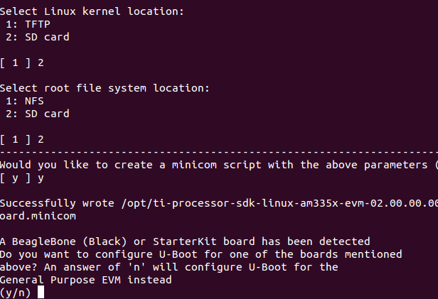

5) After, i followed the instructions "http://processors.wiki.ti.com/index.php/Processor_SDK_Linux_create_SD_card_script"  and created "Default Images"
6) I configured development environment (Minicom detected the BBB),insert the SD card into the board  and run setup.sh from SDK dir.

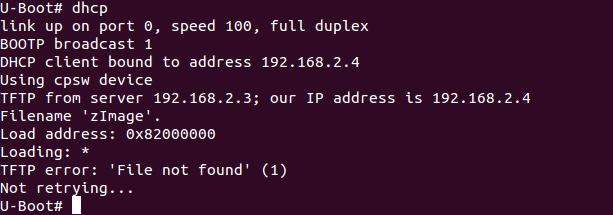

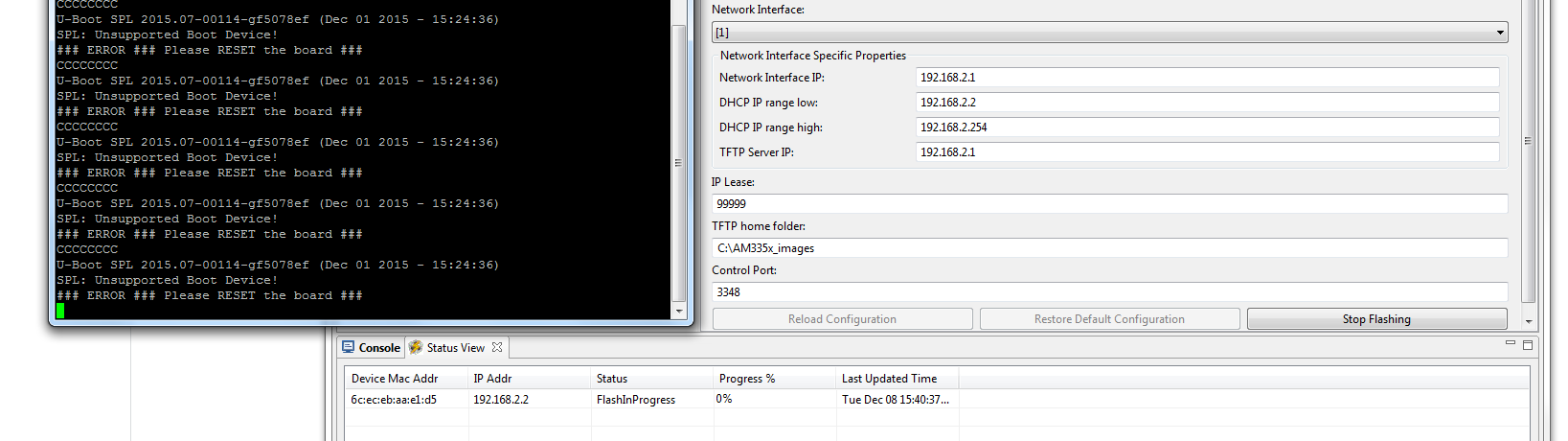

7) I restarted the board and saw
After that, I connected to the board via MiniCom, but Debian boots again.
What am i doing wrong?
I apologize for this kind of question =(
Best wishes, Svyatoslav
