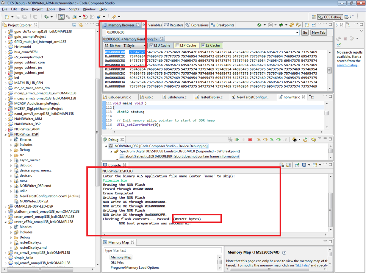

  • Hi Ahmed,
    I have experimented writing an image file to NOR memory ( S29AL032D90TFI000 )from spansion of size 32 Mb interfaced with the daughter card board of OMAPL137 SDI board.
    Using NOR writer program ( of OMAP-L137_FlashAndBootUtils_2_43) , able to flash an image of more than 32 KB ( i.e., 37630 bytes) ; which means able to (read and write) access the NOR memory beyond 32KB.
    And also tested flashing files of sizes greater than 64KB and 1MB.
    Send your image file. Let me flash and check whether flashing is successful.
    Please refer to the below screenshots.

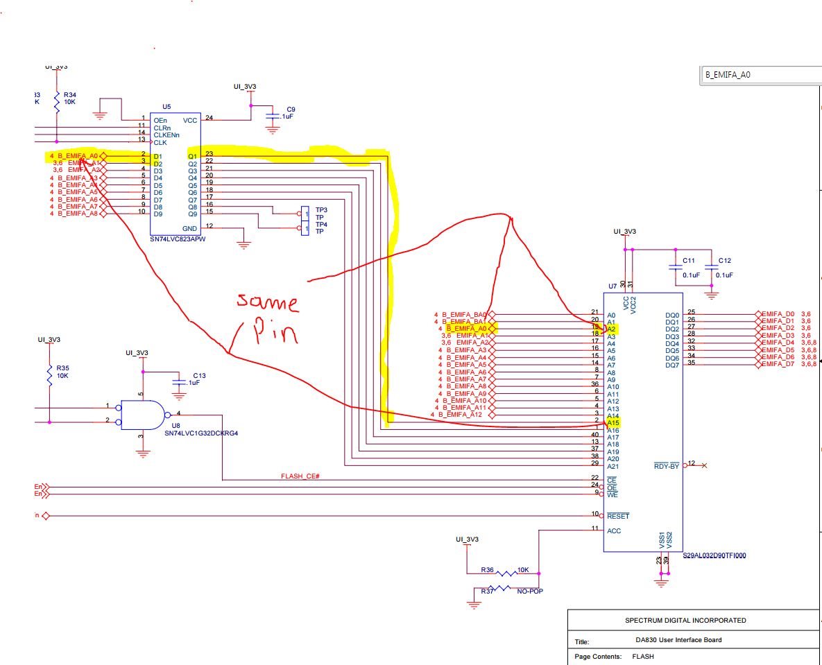

  • Thank you Shankari for your assistance,
    I got this picture from the OMAP137 schematic board :
    For my understanding, are these pins {A2 : A8} and {A15 : A21} ( upper address lines) on the NOR flash using the same pins sources from the EMIFA interface. Can you please clarify.
    Thanks for the support
  • Hi Ahmed,
    Let me loop in hardware engineers to clarify your questions.
  • Hi Ahmed,
    I guess so, we are almost close to the problem why beyond 32KB, it is not accessible.
    In the schematics of OMAPL137 Daughter card, "EMIFA_CS3n" seems to play a vital role in accessing the upper Address lines from A15 to A21.
    By tweaking the PINmuxing, your issue of accessing beyond 32 KB can be simulated.
    Experimented in the software that if CS3 is not configured in the PIN Muxing, not able to access beyond 32 KB. so, thus this clarifies that the CS3 plays a major role in accessing greater than 32KB.
    In OMAPL137, CS3 is connected and configured correctly, that's why it works beyond 32KBand able to access > 32KB.
    So , adhere to the schematic design of OMAPL137 Daughter card schematic or share your schematics.
  • Ahmed,
    The OMAPL137 EMIFA controller has A[12:0] address lines only. When there is a requirement to use more address lines you may need to use GPIOs as given in figure 5-12 in OMAPL137 device data manual. But in user interface board their implementation is in a different way, they used lower address lines and different chip select to access higher order address in NOR flash.
    Hope it clarifies.

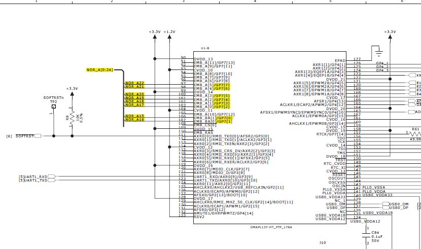

  • Hi Shankari,
    here is my schematic
    as you see in the schematic I have the last 8 address pin of the NOR flash controlled by GPIO's {GP7P0 to GP7P7} and I have included this highlighted lines inside the NORwriter project (nor.c) to be able to access upper address when we need to.
    // Get info on block address and sizes
    Uint32 NOR_getBlockInfo(NOR_InfoHandle hNorInfo, Uint32 address, Uint32* blockSize, Uint32* blockAddr)
    Int32 i;
    Uint32 currRegionAddr, nextRegionAddr;
    Uint32 GPIOADDR;
    currRegionAddr = (Uint32) hNorInfo->flashBase;
    if ((address < currRegionAddr) || (address >= (currRegionAddr+hNorInfo->flashSize)))
    return E_FAIL;
    for(i=0; i< (hNorInfo->numberRegions); i++)
    nextRegionAddr = currRegionAddr + (hNorInfo->blockSize[i] * hNorInfo->numberBlocks[i]);
    if ( (currRegionAddr <= address) && (nextRegionAddr > address) )
    *blockSize = hNorInfo->blockSize[i];
    *blockAddr = address & (~((*blockSize) - 1));
    //AS added to control upper address external NOR flash
    GPIOADDR = *blockAddr;
    if( GPIOADDR > 0x60007FFF)
    GpioAddress(GPIOADDR);       //toggle gpio's to access specific address
    break;
    currRegionAddr = nextRegionAddr;
    return E_PASS;
    but the issue is I am still having issues writing after 0x60008000. is this the right approach or I need to place my code in a different function. please clarify
    Thank you for your support
    Ahmed
