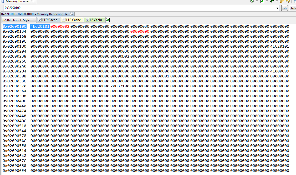

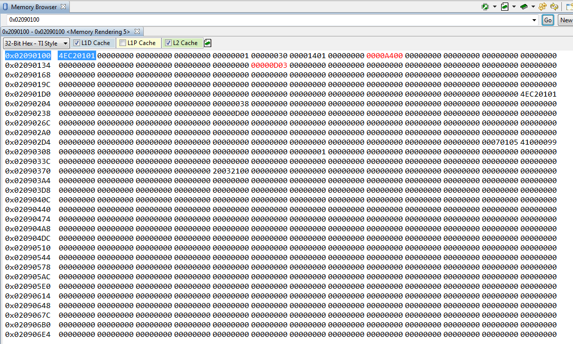

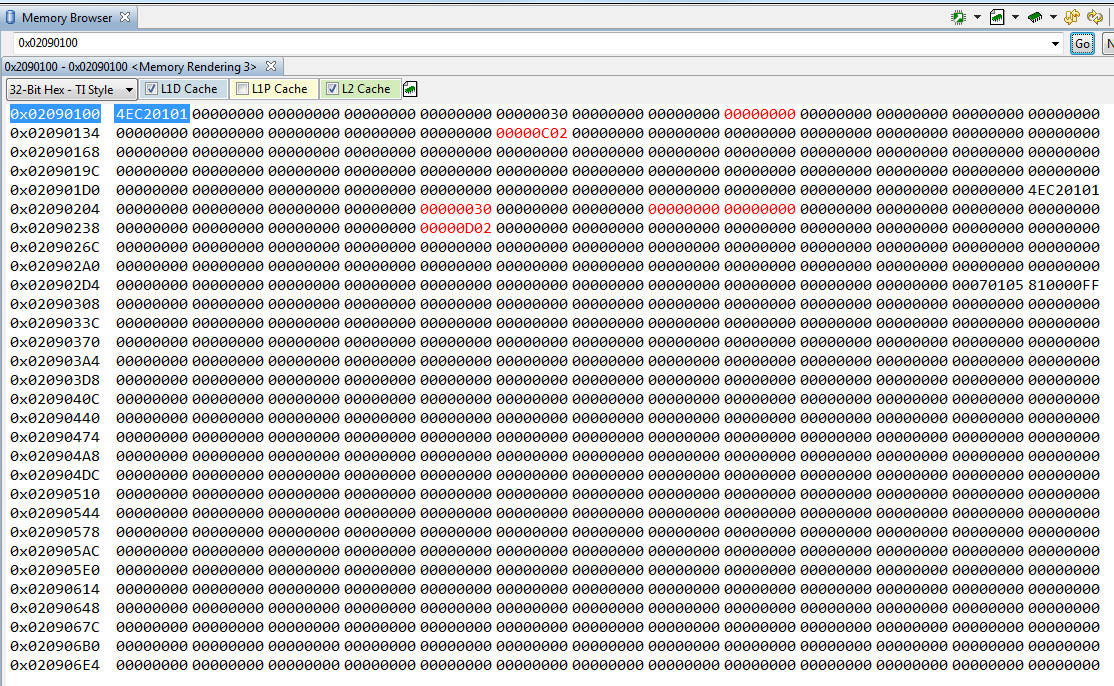

    Thank you for your answer. I insert your code in my application. Unfortunately result is not changed.

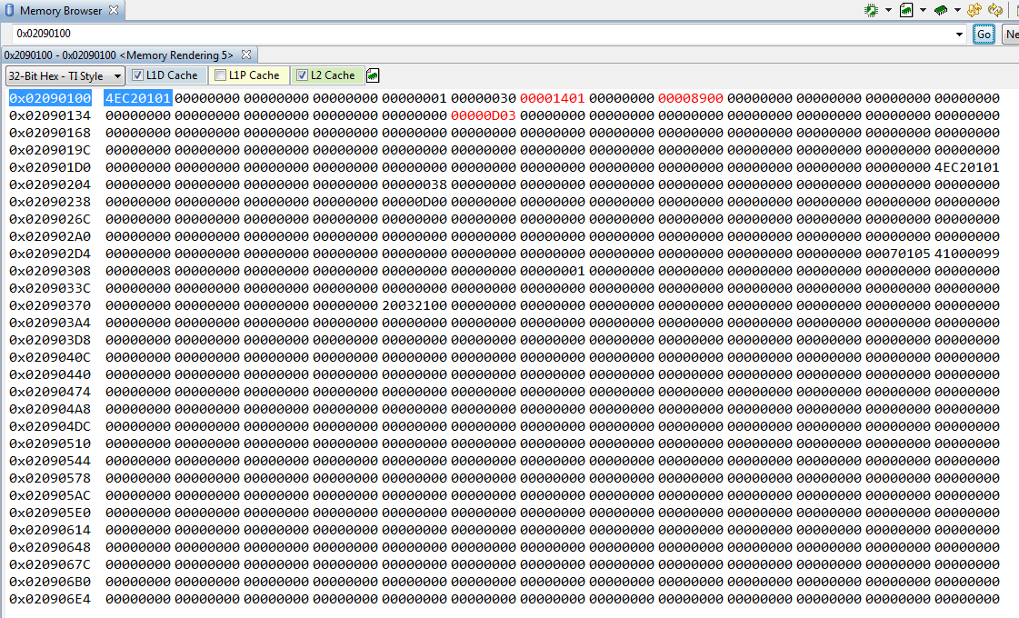

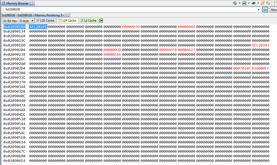

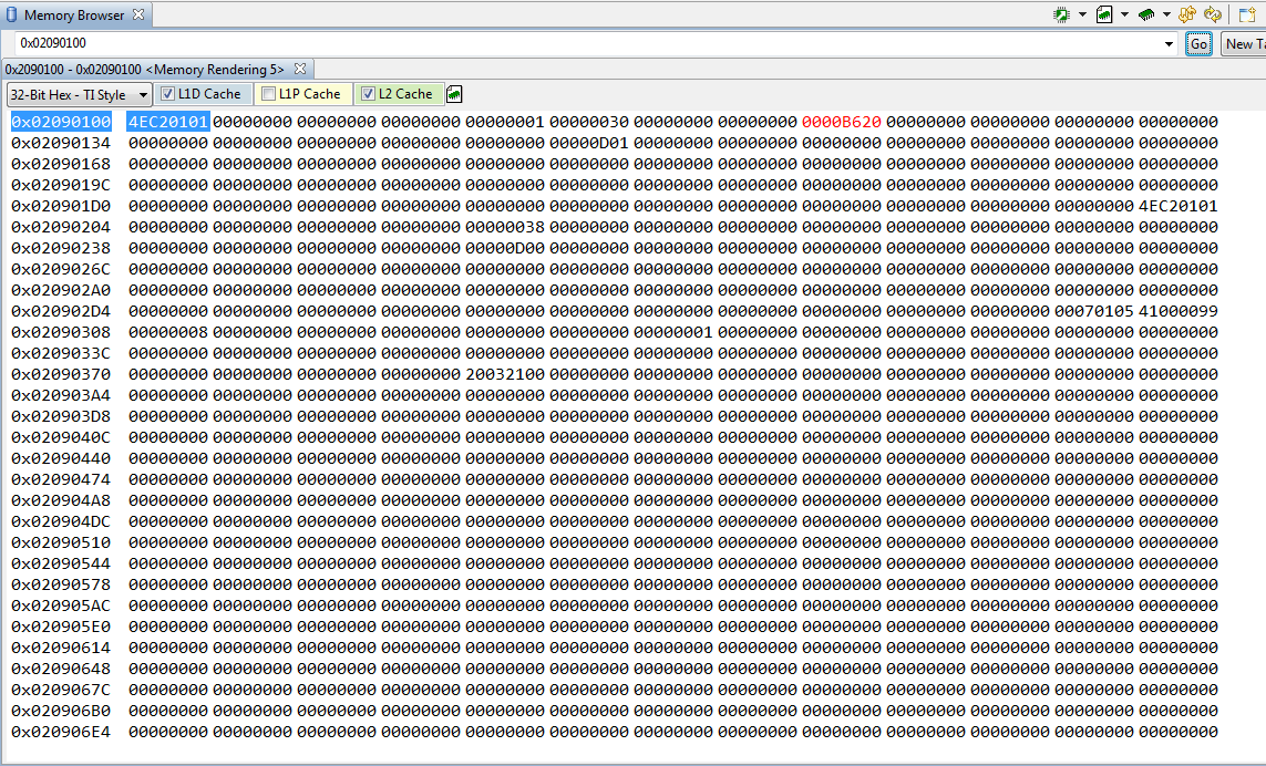

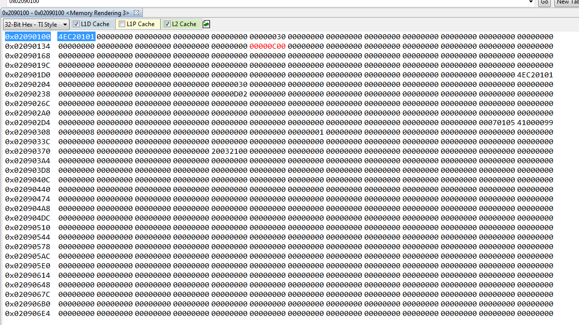

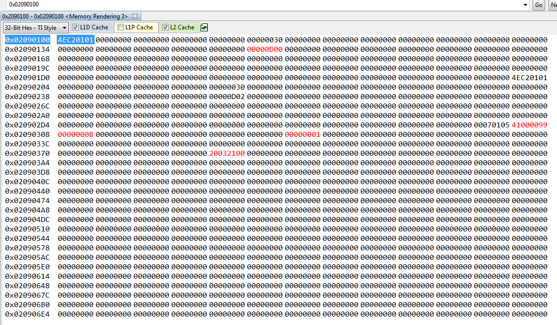

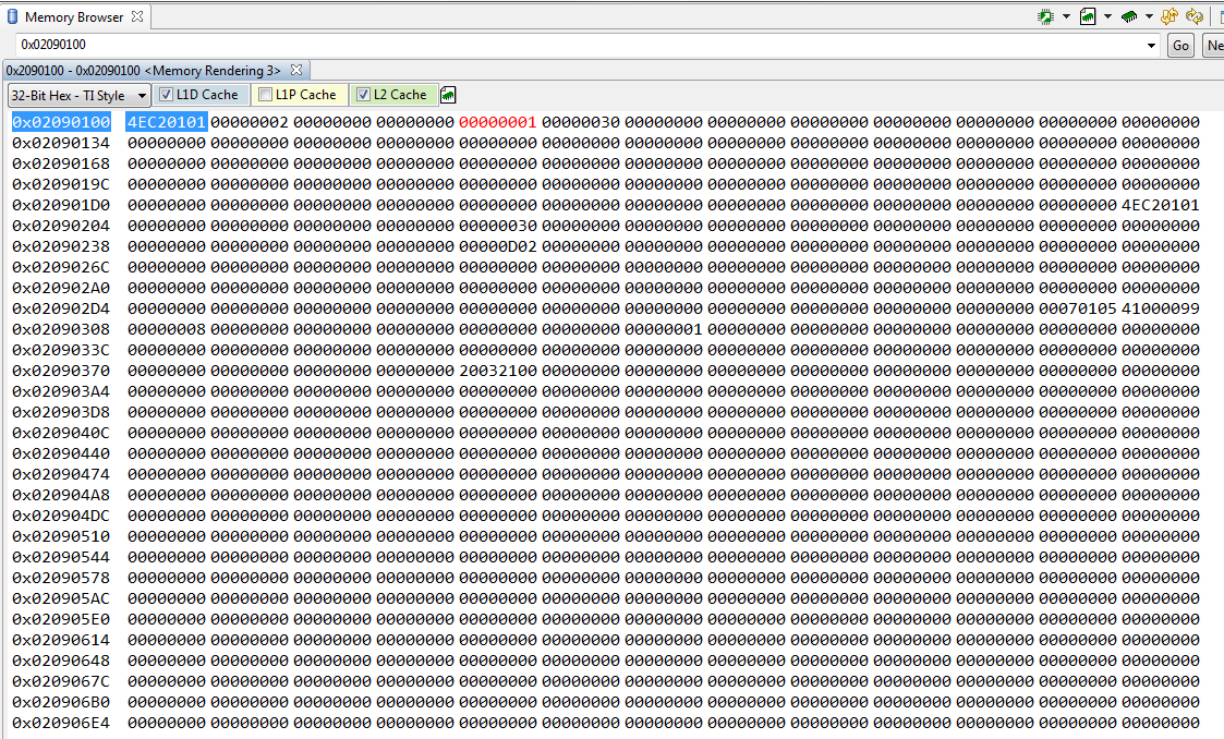

    State of registers SGMII step by step:
    Aftrer power on (_init_psc)
    After init pll
    After init MDIO
    Nexr - init port
    After  CSL_SGMII_doSoftReset(id)
    After CSL_SGMII_startRxTxSoftReset(id)
    After  CSL_SGMII_enableAutoNegotiation(id);
    Before CSL_SGMII_setAdvAbility(id, &cfg);
    After CSL_SGMII_setAdvAbility(id, &cfg);
    And Chaos - value into MR_LP_ADV_ABILITY
    Where I do errors?
       Oleg
