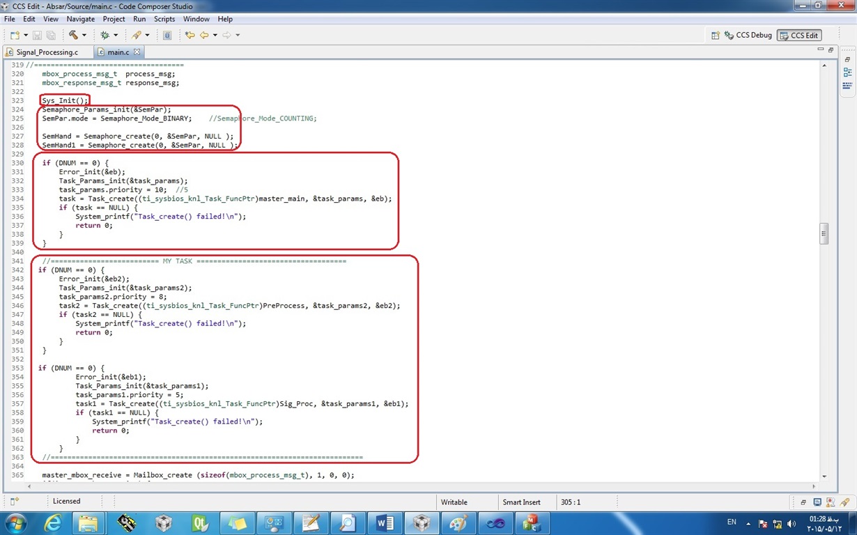

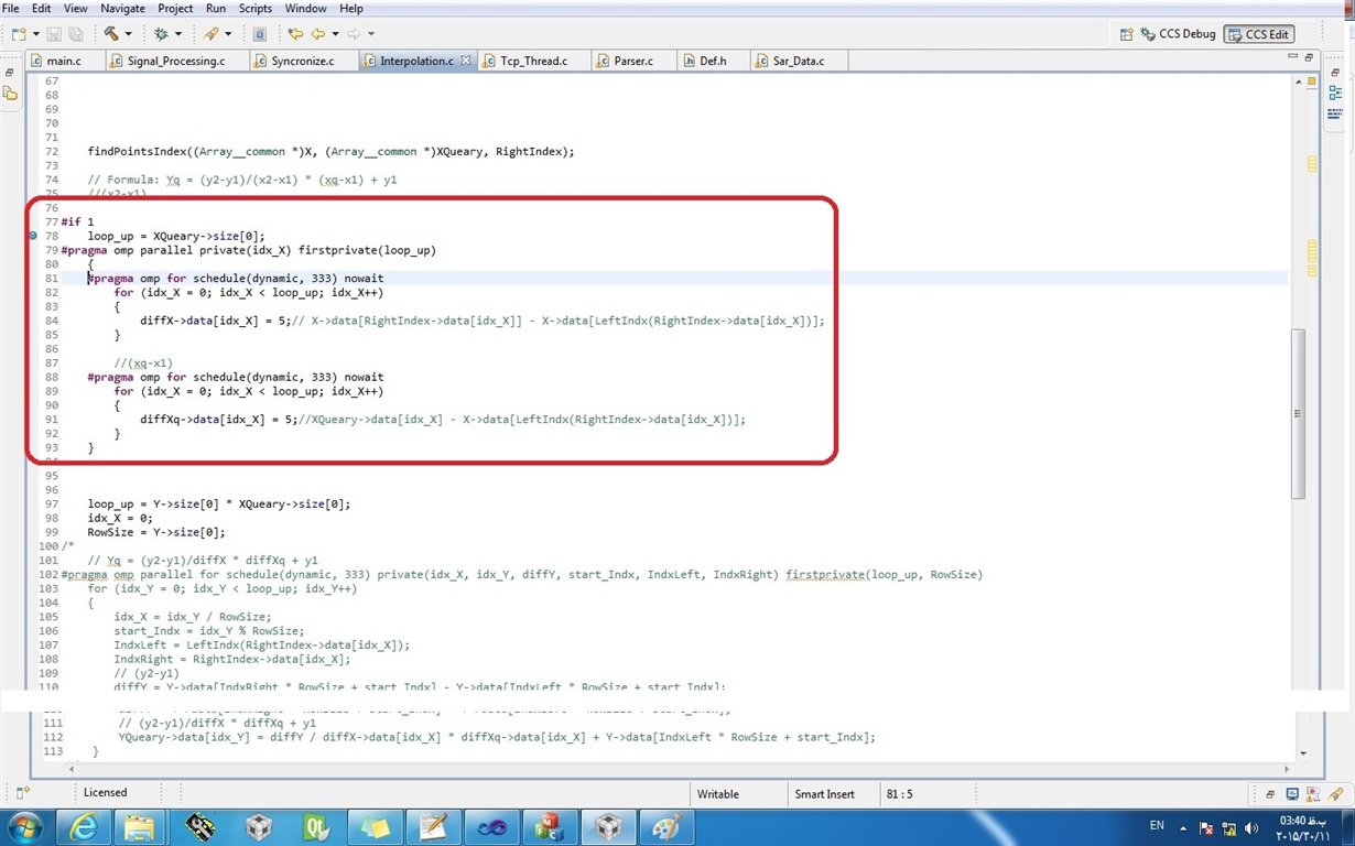

I created three tasks in the main program dynamically for receiving, parsing and processing. I wanted to use OpenMP in processing task but when the parallel region executed the program locked. It is like memory corruption error and there isn't any error message in the console.

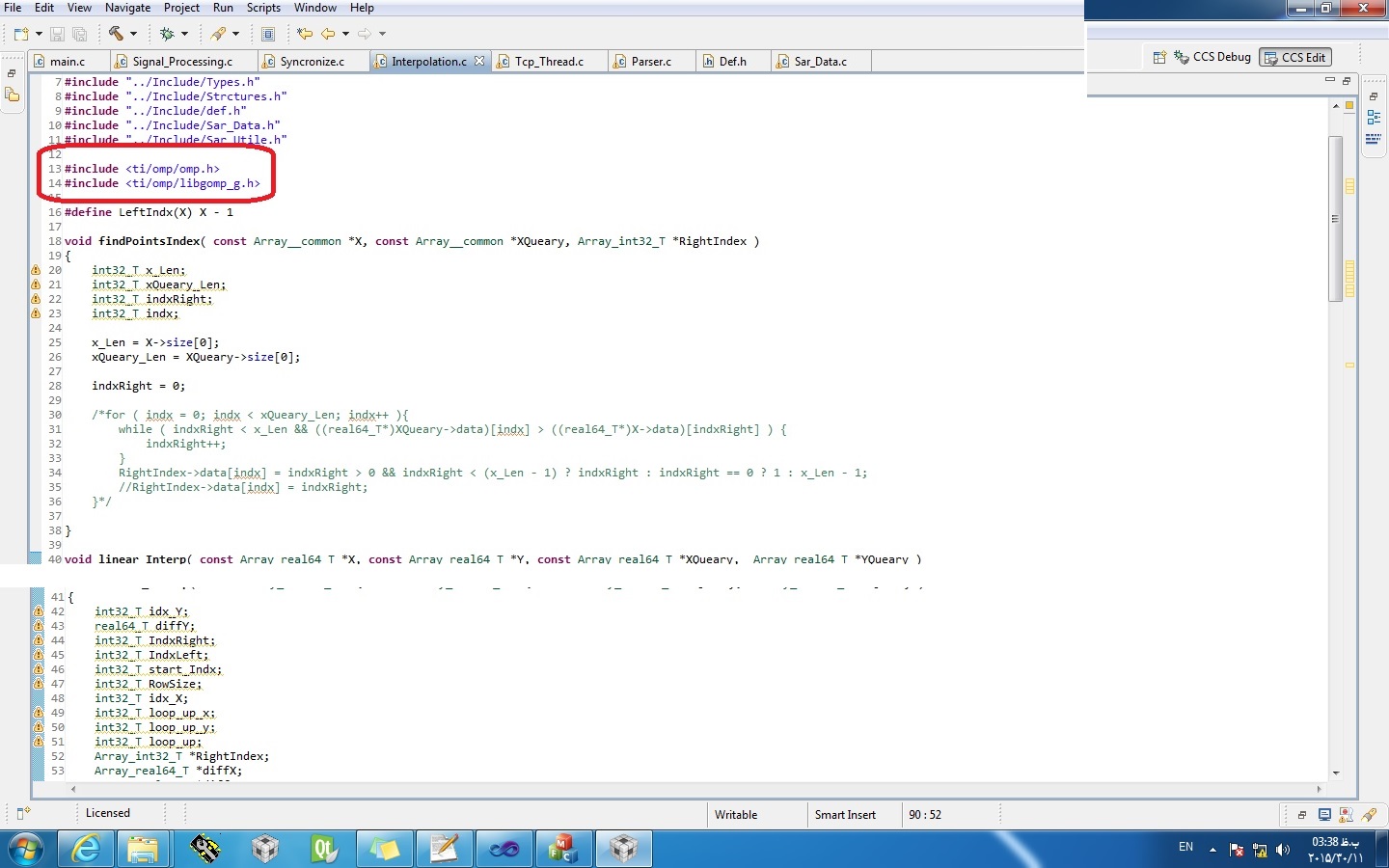

I included the include files for my ".c" file as below:
Question 1:
Is it necessary to include other include files? If the answer is yes, What includes?

  • 1. If you have selected omp based example for building the application means, it has included the necessary header files for the programs right. Are you getting any build issue? Can you elaborate your query?

    1) I made three thread dynamically for Receiving, Parsing and Processing(priority: high,medium,low)
    2) I synchronized the threads.
    3) The receiving task works real time permanently and always receives packets and put them in a ping pong buffer.
    4) The parser task parses the receiving packets and puts the data in DDR3 memory.
    5) The processing task processes data from DDR3 memory by using OpenMP.

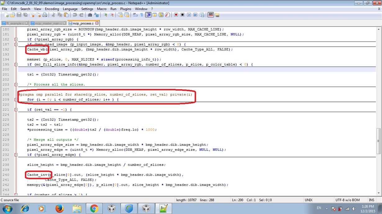

    I accomplished steps 1 to 4 successfully and now I am in step 5. I thought I only used the OpenMP synthaxes like Visual Studio but it seems I should care full about more details. I found out those when I saw the example code as below:

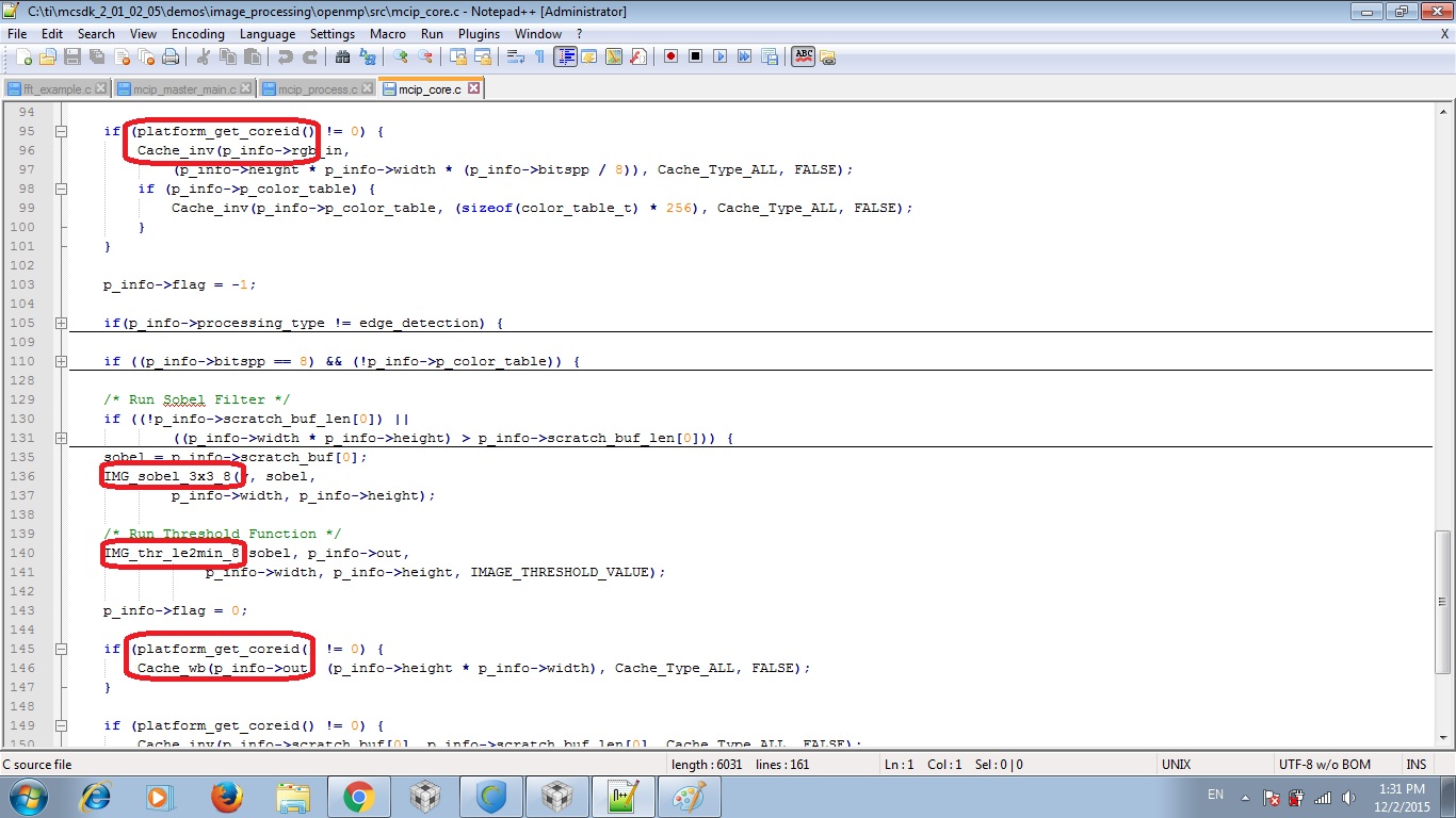

    In parallel region in line 208 a function called (process_rgb() ), In this function the cache function used as below:
    My Questions:
    Question 1:
    When I used " #pragma omp for or ... "  should I manage Cache memory like above? If the answer is yes how should I do it? is there any reference?
    I have studied " C:\ti\omp_1_01_03_02\docs " User_Guide.pdf, but it didn't help me.

    1. In the for loop of your test case shown above, you don't need to manage cache coherence manually. You may find the document is useful to understand C66x cache usage:

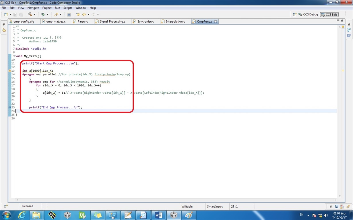

    2) After I tested the the project and it worked correct, I commented the main syntax and call a function as below:
    2) I wrote an OpenMP function as below:
    This function worked correctly.
    4) In my base project at the main I called a function " Sys_Init() " for initialization as below. I copied the the parallel test code from My_test() function to start of this function and ran the project. This piece of code worked correctly.

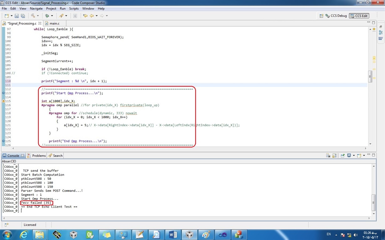

    5) I described about the tasks in my project before, after that I copied my parallel test code in the start of Sig_Proc() task function as below. when the Sig_Proc() task run it spent infinite time as the master_main task disconnected and print the " recv failed (35) " message as below.
    As shown above the parallel test code worked in a function but didn't work in a task function!!!
