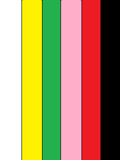

 I am trying to output lcd display graphic 240x320.
When triggerting test color bar (internal davinci register), I see color bar stable and clean, but on rendering image with fbdev, I get v-sync movement .
I have tried to check the assumption that the color bar stability is only because of its vertical lines, so I created the following image (note that it contain a white bar in the left too, it is on white background so hard to notice)
 But on rendering it with fbdev I still got v-sync movements:
https://drive.google.com/file/d/0B22GsWueReZTMEI0QTlic0h6N0U/view?usp=sharing
It also seems to be shifted (in the LCD I see the pink and red bards in the margins instead of white and black, note that it is not the same bar as the internal color bar test in hdvpss)
I still don't understand what it means, maybe rendering through fbdev change the timings ?
I also tried to display white image (240x320) and I still see some lines.
Is it becuase fbdev changes timing compared to the internal color bar test ?
    This resolution (QVGA in portrait orientation) is not supported by default in the ti81xx linux kernel. May be this is the root case. Can you try with some of the officially supported display resolutions, will you have the same issue?
    Check linux-kernel/drivers/video/ti81xx/vpss/sysfs.h to get name of the supported modes.

    I work only with LCD 240x320 on the custom board, but I have EVM 800x480 to compare with.
    On trying almost same kernel(pinmux change) in EVM with 800x480 LCD it works fine with fbdev .
    When I do :
    echo 6500,240/1/22/2,320/2/1/1,1 > /sys/devices/platform/vpss/display1/timings
    it seems to have an effect. the test color bar is stable, so seems that vpss is configured, even if sysfs.h does not include this mode.
    Maybe adding the custom timing for 240x320 in this header will make a difference ?
    Ran

    The main mystery is that after setting
    echo <correct lcd settings> > /sys/devices/platform/vpss/display1/timings
    The internal color bar seems to be perfect, but trying to render image through fbdev has problems (as seen in my above links).
    I checked during fbdev rendering the value in sys/devices/platform/vpss/display1/timings, but it is the same as with the color bar.
    So I don't yet understand how it is that the color bar is perfect while any fbdev image write is bad.
    Ran

  • Hi Pavel,
    I can't see this issue with EVM, but since the resolution is quite rare (240x320) , it could be that some driver such as fbdev, does not support it ?
    It also seems that timing is OK becuase the internal color bar is perfect,
    So it seems that on moving  to fbdev, something gets wrong.
    Since the supsicious is on fbdev settings,  in continuity effort to understand the LCD 240x320 failure when rendering image through framebuffer,
    please take a look at the tests below, each time I've change one parameter in framebuffer.
    Usually I got the following image result (this is named "Result 1" in below report)
    Note: the video starts with showing the internal color bar (which is different and does not use fbdev), than from 00:11 second you can see the result with fbdev)

  • Hi Pavel,
    I have made some progress.
    I changed the timings, and got a stable picture - BUT every time it started with a different vertical offset.
    the timing I use is:
    echo 6500,240/1/100/14,512/1/1/10,1 > /sys/devices/platform/vpss/display1/timings
    though the strange about this timing is that the number of lines is 512 instead of 320 !!
    Maybe that exaplin the issue of the image displayed each time starting at different line ?
    Eventually I found that if I do:
    dd if=/dev/zero of=/dev/fb0 bs=3200 count=600
    It solved the starting line offset problem !
    Do you have any idea what the effect of this and why did it solved the line offset issue ( the framebuffer starts with same physical address, so I don't understand what the effect of this )
    When I tried to output video, I still got the same issue , it always starts in another vertical offset. But this time - I don;t have any /dev device.
    Do you have any idea how this can be resolved for video?
    Ran

  • This issue been resolved.
    Failure in HW which resulted in wrong timing !
