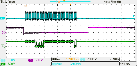

I’m Having trouble in getting SPI interface work with ADS1292.  Basically, what I’m facing is my SPI clock is’t coming.
I searched through e2e forum and I got one link who had similar problem(http://e2e.ti.com/support/embedded/linux/f/354/p/340805/1194573#pi317016=1). Accordingly I did all my configuration. But still I don’t have luck. Could you be able to guide in this regard?
I understood that there is no readily available driver code for ADS1292. So trying to use available driver.
The changes are made in am335x-evmsk.dts
I have added the device tree for spi is as follow. (sdk 7.0 and kernel  version 3.12.10)

    Which processor pins are you using for SPI? Please post pin numbers.
  • Processor pins are  A17,B17,B16,A16
  • OK, these are correct pins for SPI0. Two things to check:
    1. Check that the pinmux settings do not get overwritten by another pinmux later in your DTS file.
    2. This is secondary but important: SPI0_CLK must be pinmuxed as PIN_INPUT| MUX_MODE0, otherwise SPI receive will not work.

    I've used the following configuration on my BBB, running kernel 4.1:
    &spi1 {
          status = "okay";
          pinctrl-names = "default";
          pinctrl-0 = <&spi1_pins>;
          spidev@1 {
                    spi-max-frequency = <24000000>;
                    reg = <0>;
                    compatible = "linux,spidev";
           spi1_pins: spi1_pins {
                 pinctrl-single,pins = <
                       0x190 (PIN_INPUT_PULLUP | MUX_MODE3)  /*MCASP0_ACLKX.spi1_clk*/
                       0x194 (PIN_INPUT_PULLUP | MUX_MODE3)  /*MCASP0_FSX.spi1_d0*/
                       0x198 (PIN_INPUT_PULLUP | MUX_MODE3)  /*MCASP0_AXR0.spi1_d1*/
                       0x19C (PIN_INPUT_PULLUP | MUX_MODE3)  /*MCASP0_AHCLKR.spi1_cs0*/
    As a result I got the /dev/spidev1.0 in my fs. To test the interface I used the spidev_test.c example from Documentation/spi/ & got the interface working (I executed root@am335x-evm:~# ./spidev_test -D /dev/spidev1.0 -s 2400000 -2):
    I was able to see the pins toggle, when setting the clock to up to 24 MHz, but my scope is not that fast & the wave-forms were not that good.
    Yordan
  • Hi Biser
    I also met the SPI Device working fail. You said that SPI0_CLK must be pinmuxed as PIN_INPUT| MUX_MODE0. Is it the same with SPI1_CLK ?
  • I'm no device tree expert but agree with Yordan as non-intuitive as it might be, all the SPI pins are defined as PIN_INPUT.
