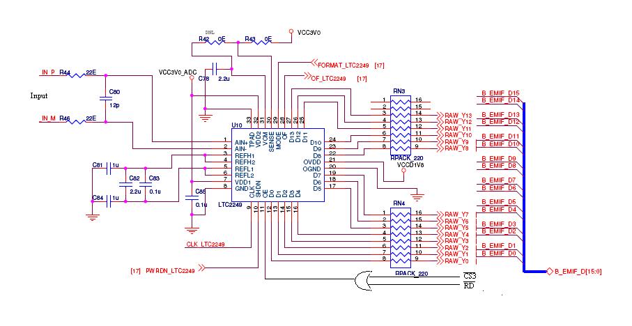

We have an issue in EDMA3 Data transfer from EMIF address space. We are getting only around 8MB per sec.
We need to improve at least 3 times (23MBps) for our requirement. Capture some 8k samples on one shot from ADC.
We don’t need to repeat this to capture continuous data.
Processor:                    Davinci DM6467
Buss Interfaced:            EMIF
Transfer Between:         EMIF to DDR
Device Interfaced:         LTC 2249 (14-bit ADC)
 As we have only one device interfaced to EMIF we connected the ADC chip enable logic from the EMIF RD and CS3.
 Please suggest how I can improve the capture rate.
Satya.

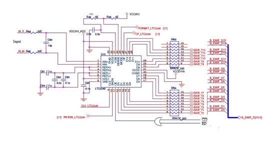

    We have an ADC connected directly to the emif Databus. As we dont have any other EMIF devices, we have generated the chip enable from the CS3 line and EMIF READ Signal.

  • Satya,
    Can you please provide the schematic of the ADC to DM6467 EMIF interface.
    Regards, Srirami.
  • Hi Srirami,
    as i mentioned earlier only EMIF databus is connected. functionality wise its working ok, but only problem is we are unable to read at required datarate.
    Satya,
