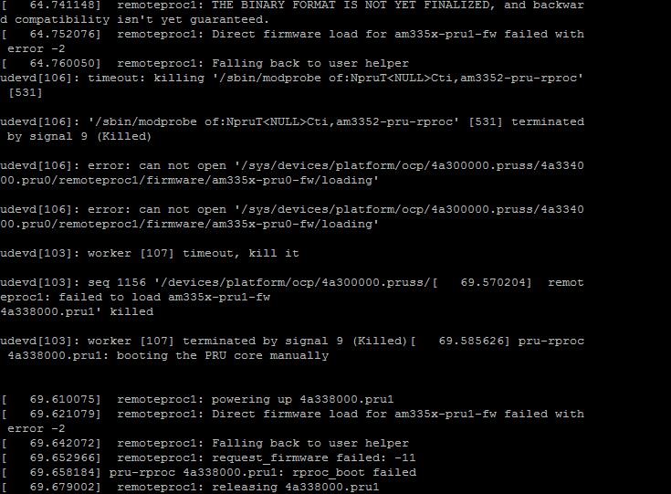

Hello everyone!
I have a problem, again: it's with booting Kernel
I build own Kernel with PRU support and followed these steps:
1) Installed SDK evm-02.00.00.00-Linux-x86
2) Then, i installed PRU Software Support Package and edit .configure file
3) Then, i followed this guide: processors.wiki.ti.com/.../Linux_Kernel_Users_Guide
3.1) i completed this "Installing the Kernel Image and Device Tree Binaries" in dir /home/rootfs/boot
3.2) i get "file system" from tar. /home/rootfs
3.3) i completed "Installing the Kernel Modules" in /home/rootfs
4) Then i ran SD card script --> chosen custom images.
4.1) Because I do not have MLO and u-boot, i take them from <sdk-path>/board-support/prebuild-images. How to build own MLO and u-boot? (this guide I didn't understand
5) Insert SD card on board and power on
[    0.000000] Booting Linux on physical CPU 0x0

[    1.120294]  remoteproc0: wkup_m3 is available
[    1.125034]  mmcblk0: p1 p2
[    1.128686]  remoteproc0: Note: remoteproc is still under development and considered experimental.
[    1.137851]  remoteproc0: THE BINARY FORMAT IS NOT YET FINALIZED, and backward compatibility isn't yet guaranteed.
[    1.149553]  remoteproc0: Direct firmware load for am335x-pm-firmware.elf failed with error -2
[    1.162974] oprofile: using arm/armv7
[    1.166972] Initializing XFRM netlink socket
[    1.171296] NET: Registered protocol family 17
[    1.175920]  remoteproc0: Falling back to user helper
[    1.181222] NET: Registered protocol family 15

ogin: [   64.582148]  remoteproc1: failed to load am335x-pru0-fw
[   64.587506] pru-rproc 4a334000.pru0: booting the PRU core manually
[   64.595324]  remoteproc1: powering up 4a334000.pru0
[   64.600555]  remoteproc1: Direct firmware load for am335x-pru0-fw failed with   error -2
[   64.609304]  remoteproc1: Falling back to user helper
[   64.615965]  remoteproc1: request_firmware failed: -11
[   64.621169] pru-rproc 4a334000.pru0: rproc_boot failed
[   64.627380]  remoteproc1: releasing 4a334000.pru0
[   64.632456] pru-rproc: probe of 4a334000.pru0 failed with error -11
[   64.639560]  remoteproc1: 4a338000.pru1 is available
[   64.645866]  remoteproc1: Note: remoteproc is still under development and considered experimental.
[   64.655029]  remoteproc1: THE BINARY FORMAT IS NOT YET FINALIZED, and backward compatibility isn't yet guaranteed.
[   64.666492]  remoteproc1: Direct firmware load for am335x-pru1-fw failed with    error -2
[   64.674669]  remoteproc1: Falling back to user helper
[   69.591061]  remoteproc1: failed to load am335x-pru1-fw
[   69.600162] pru-rproc 4a338000.pru1: booting the PRU core manually
[   69.607339]  remoteproc1: powering up 4a338000.pru1
[   69.612707]  remoteproc1: Direct firmware load for am335x-pru1-fw failed with    error -2
[   69.620681]  remoteproc1: Falling back to user helper
[   69.634226]  remoteproc1: request_firmware failed: -11
[   69.639452] pru-rproc 4a338000.pru1: rproc_boot failed
[   69.645653]  remoteproc1: releasing 4a338000.pru1
[   69.650649] pru-rproc: probe of 4a338000.pru1 failed with error -11

    About the errors you see:
    1). Have you tried fsck for your filesystem? This may be useful in removing the EXT4-fs errors.
    2). As for the remoteproc errors, I have a couple of questions:
    Are you loading the binaries from /firmware folder in your kernel sources (in other words are you using built-in binaries)?
    or
    Are you loading the .elf files from the filesystem with the use of init scripts? In that case inspect your fs (if elf are present) try with fresh copies, maybe the firmware images were damage when copying them on your sdcard the first time (/sbin/init: error while loading shared libraries: /usr/lib/libc.so.6: invalid ELF header)
    Yordan

    Agaro starts, but error with PRU remained.

    Were you able to successfully apply the pru-rpmsg & virtio patches:
    0002-rpmsg-pru-Add-a-PRU-RPMsg-driver.patch
    0003-virtio_ring-break-out-vring-descriptor-setup-code.patch
    0004-virtio_ring-revise-descriptor-addition-logic-for-vir.patch
    0005-virtio_ring-add-virtqueue_add_inbuf-outbuf_rpmsg-API.patch
    0006-rpmsg-fill-in-dma-fields-for-sgs-passed-to-virtio.patch
    Yordan
