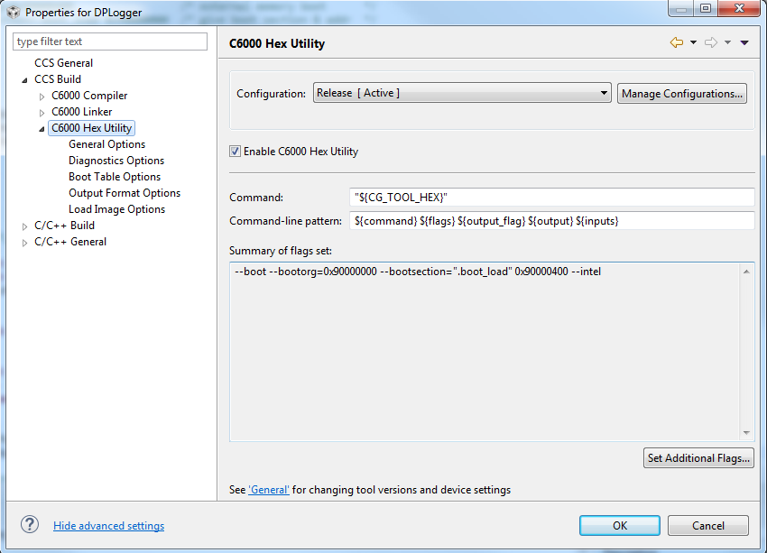

I work with a board with processor C6727 in CSS v6 and use "boot_c6727.asm"
I do not quite understand how you can make bootlodering  from a parallel flash ( board is the  same as evaluation board).
In map file bootloader  is plased in 0x10000004 instead 0x90000000. Why?

And boot_c6727.asm file contains section ".boot_loader"
            .sect ".boot_load"
            .global _boot
            .global ___binit__
CCS says :  "section DPLogger.out(.boot_load) at 090000400h overlaps (boot table)   DPLogger     C/C++ Problem"
What is wrong?
2.
How to write the image into flash?
Do need me use some utitility or application?
CCS can do that?
