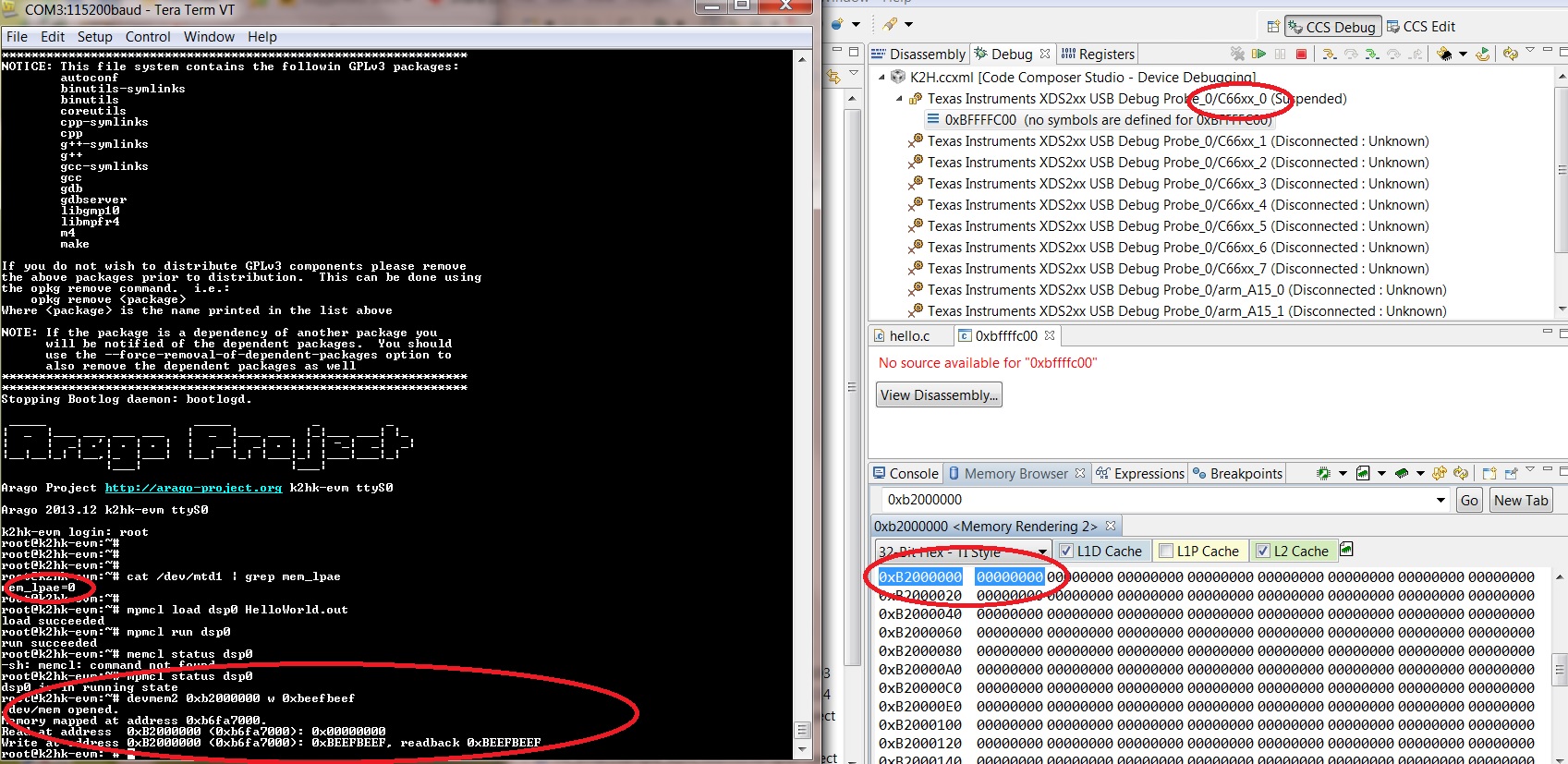

    I don't see the behavior as you described with lpae=0 even running mpmcl. mpmcl does not configure anything. Please see the screenshot of my test. I had kernel up and shows mpm_lpae=0 in the u-boot env variables (highlighted red circle).  A small dsp program was loaded and run. The DSP is in run state afterwards. Then, ARM modified the memory at 0xb2000000 (highlighted with red circle). Then DSP0 was connected through CCS and memory 0xb2000000 was dumped. It didn't show the value entered by ARM.

    I did a very similar test as yours, but apparently I get a different result. Inside the green box you can see part of the DSP code running on DSP2. Inside CCS, the memory view is the "CPU memory view" as in your case (I needed to refresh the memory to get the value written by ARM). In addition, as you can see inside the ARM console, when printing the DSP trace it seems that the DSP is able to read and print-out the right value written from the ARM side.

    Did you run any gel file to configure DSP? Is the MPAX register configured? My target was launched without any gel file running. I'll discuss with one of my coworkers who is out on vacation and be back Monday to see what's his opinion and comment. I had an earlier discussion with others that mem_lpae only disable the linux kernel, but not DSP's capability to access space with 40-bit addressing if MPAX is configured. I want to verify with this coworker when he comes back.
