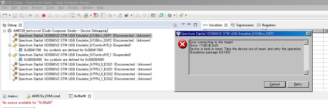

I made a "ACCULE-Board (AM57xx)".
(Please see the attached photo)
Only C66x_core could not be connected.
(Please see the attached)
Please tell me how.ACCULE-Board-PHOT.pdf

After a device reset, the C66xx cores are held in reset, which will lead to the "Device is held in reset" error.ike said:Only C66x_core could not be connected.
Before CCS can connect to a C66xx core the C66xx needs to be released from reset by the ARM code. You should be able to do this by using the AM5728 GEL scripts in the CCS installation, see
[I don't have an AM5728, so haven't tested this myself]
